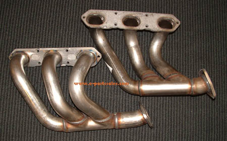

It's supposed to make a subtle improvement in mid range power and torque. No difference in sound and since they are Porsche they will fit perfectly with my PSE.
I acquired them for a very good price and the stock "S" headers are really poorly designed.
Even the aftermarket tuners admit they cant improve on the X 51 design (but they sure can charge a lot more money.)
Below are pics of the stock "S" headers (bottom pic) and the X 51. Don't have to have a degree in fluid dynamics to see which is the better design...

why do you think the stock headers are a poor design?
Edited by george996
thanks for all the tips. The stock headers on the "S" are very restrictive. I have no idea why Porsche changed from the tried and true X 51 header and went for this design.

For the sake of discussion...
I keep seeing posts that condemn the 997S headers, but I'm not yet convinced that they are as bad as everyone believes. Most of the posts seem to indicate that they LOOK like they are restrictive, but here are a few things to consider.
1) Porsche engineers work very hard to coax the maximum amount of power from these six cylinder marvels, so why would they intentionally reduce horsepower on their higher end engine by replacing a more efficient header (X51) with one that is less efficient? Doesn't make sense.
2) People keep saying that the S headers are restrictive because the three tubes go through the same restrictive point. This would be a problem if all three cylinders were evacuating gases AT THE SAME TIME, but imagine the flow through this header with each cylinder exhausting gases in SEQUENCE. Under those conditions you might actually set up a continuous high velocity flow (taking advantage of the restriction to impart a venturi effect) that would help to suck the gases from each cylinder. If this is the case, we should be removing our X51 headers and replacing them with all of the discarded 997S headers. :huh:
3) I agree that an an obvious design flaw present in the S headers is that the tubes are not of equal length.
I don't have a CS (I have a C4), but if I did, I would have to see a decisive dyno comparison before I changed headers because the risk is that you may actually be reducing power by swapping headers.
Point taken.
I will agree that there is a chance that the X 51 headers may reduce power. I put cat bypass pipes on my old 996 and it killed the low end power and torque.
I feel confident in the swap to the X-51's because several tuners that I know have blessed the swap when I mentioned it to them. I tend to disagree with the argument that "if Porsche could have designed a better header they would have" as baloney.
They saw a chance to cut costs and that's what they did. It's a bad design.
Look at every header from the 993, 996 and 997 (including Turbo and GT3) and not one is designed like the 997-1 "S" header. The 3.8 is basically the same freakin engine as the 3.6.(which has the X 51)
So Porsche came up with this awesome header for the 3.8 'S" but decided not to share it with the other variants??? I don't think so.. Not to mention the 997-2 "S" has a completely different header.
I guess this is true if the engine RPM is low (low exhaust gas flow). Depending on how fast the exhaust gas excavated from that junction, in higher RPM, this "venturi" effect may create a problem (bottle neck).
I would guess the X51 header is designed to improve the top end performance. The low end performance may be compromised.
