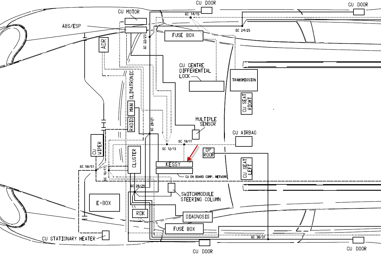

Do you know where on the car the unit is located? I might try to source a second hand unit and have it re-coded at at the dealer. I shudder to think what a new unit would cost.

Also I assume this diagram is for a LHD car. Mine is RHD so I assume the module is located on the right hand side in my car? ie locations are mirrored.
