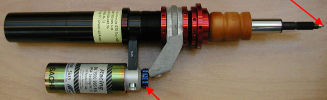

I think Mike wants a set of these...  ;)
Loren,
Very cool! I think that may be exactly what I'm looking for! Now, why do I think I'd better find that big roll of hundred dollar bills........ :P :P :P
I have the technical specs on the Sachs Formula Matrix Dampers if anyone wants it email me. Has lots of great pictures and charts. I'm waiting on pricing. Are those the same ones that are standard on the Cup Cars now?
