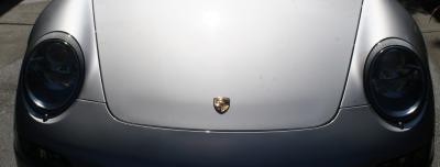

The indentation is at the front edge of the front hood:
It starts about one inch behind the leading edge for about 3 to 4 inches back and across the entire hood with the same margin on the sides. It is very slight and symmetrical.

It took me awhile to find the right position and lighting to see the indentation. I had practically given up until I went outside this morning and saw it more clearly with the Sun towards the back shining forward across the hood (its that slight of an indentation. Tell me what you think?

The picture doesn't show how even the indent is across the entire hood but the last inch or so on either side. Interesting thing is now that I know what to look for I'm seeing quite a few. I'm going to stop by the dealer and look at new cars to see if they have the same issue.
I looked on the inside of the hood and noticed a piece of rough almost fabric like but maybe metal material that follows the same outline. You have to get your head far enough back so you can look back towards the front. Looking through the holes you can see this material/fabric I mention. The fabric seems to be the same outline as the indentation. Possible reasons for the indent:
Designed this way to reduce the whistle noise (as mentioned by dphatch in this post)
Caused from pushing the hood closed
Optical illusion caused in the paint
Something to do with this fabric stuck to the inside of the hood (ie: in applying the fabric it causes the hood to change its shape.
It was like that from the beginning and maybe a defective part
Any other possibilities?
Edited by jroach
Mine looks the same. Great picture by the way. I didn't think you'd be able to actually get a picture of it given how difficult the effect is to see with the naked eye.

I don't have the clear bra but your explanation (pressure to remove air bubbles out) makes sense. Can I bother you to look under the hood at the front under the supporting structure to see if you have any material bonded/laminated to the skin? I haven't had the time to swing by my local dealer in Pasadena but will try and get by next week.
One more thought. My hood has clear bra on it. Given the pressure necessary to remove all the air bubbles from the material during application is it possible, going on the premise that the AL hood is somewhat fragile, that during this process the metal was flattened out ? This is really a stretch though as the application of pressure would be applied to the entire section having the clear bra applied as well as the sections adjacent to it where the flat edged plastic tool runs off the material onto the hood during the install process. Those sections of the hood show no signs of any flattening at all and given the clear demarcation area where it starts and stops the metal would have to significantly weaker in this area than anywhere else on the hood. Only thing that makes sense is that is was a deliberate factory design. Why ? Can't say outside of the whistling hood theory.
Just checked and the bonded material, looks something like fiberglass about 1/8" thick, is where you described it would be. Given the fact that it starts at the same spot on the hood that the "indentation" appears and runs forward it was definitely out there for a purpose. Adds support to the idea that the indentation, or maybe better described as a transition from the compound curves of the hood to a flat section, was an intentional factory design. My guess the purpose is to minimize or eliminate the possibility of denting or compressing the hood when closing it. However, it could just as easily been designed with a curve in to maintain the flow of the rest of the hood so there is still one question unanswered. Why has the hood been flattened in this area ?
