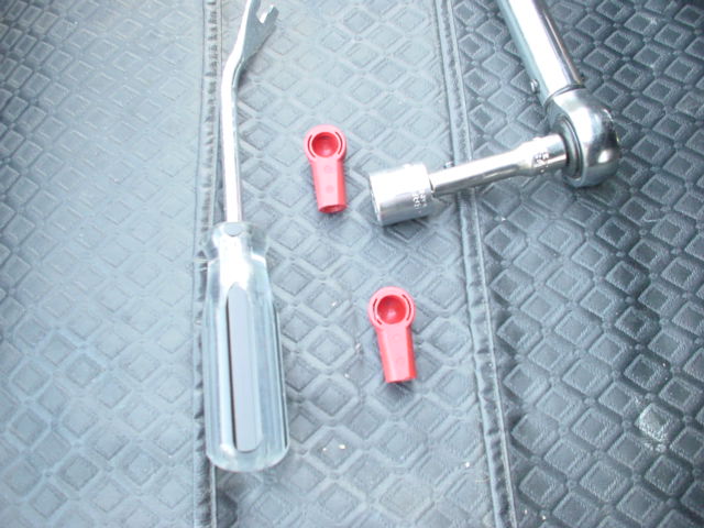

This is the door panel removal tool I use to separate the 4 joints, and it sounds like James has the same kind of tool. Funny, but I bought it years before I owned a Boxster. Mark likes to use the pry lever in the tool kit.
Like James said, you are working by feel to release the joints from the clamshell if your top is stucked in the closed position. And it takes some force to separate those joints.
