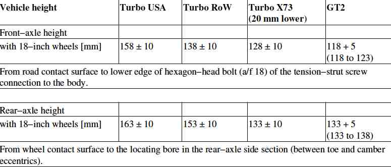

First I assume you are at US height as opposed to ROW height. I would not recommend the set-up you suggest. It would be dangerous handling wise. You have the following options:
1. X73...The factory X73 retrofit kits lowers the US cars 40mm (1.6") in the front and 30mm (1.2") in the rear.
2. Coil Over set-up (JIC, PSSX, JRZ, Motons, etc.)
I run PSS9s (Euro version) with the same rims you have.

There may be different PNs for Tips...but the advice is the same
