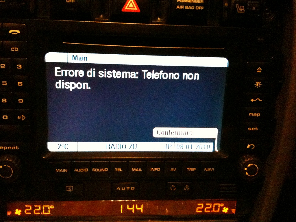

Guest omulghicitoare
I have EXACTLY the same problem !!! ((
My navigation PCM2 for porsche cayenne says... System error: phone not found .. Press Confirm
and NO BUTTON IS working except volume ((
any one have a fix for this please ???
