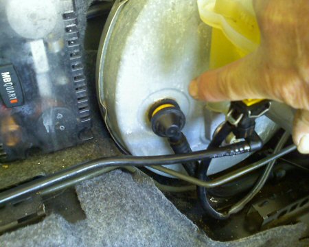

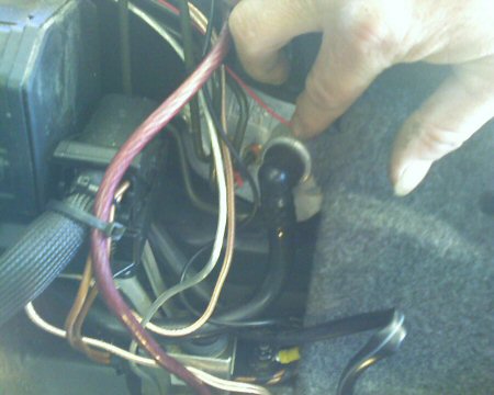

Boy that booster looks like a pain in the xxx to change but where is the check valve and if by the picture this is it does it just pull out of it? Also the line goes to something I'm not familiar with anyone venture a guess.

Pic. 1 shows one way valve (pulls out), Pic. 2 shows connector via intermediate part to line coming from engine compartment.
