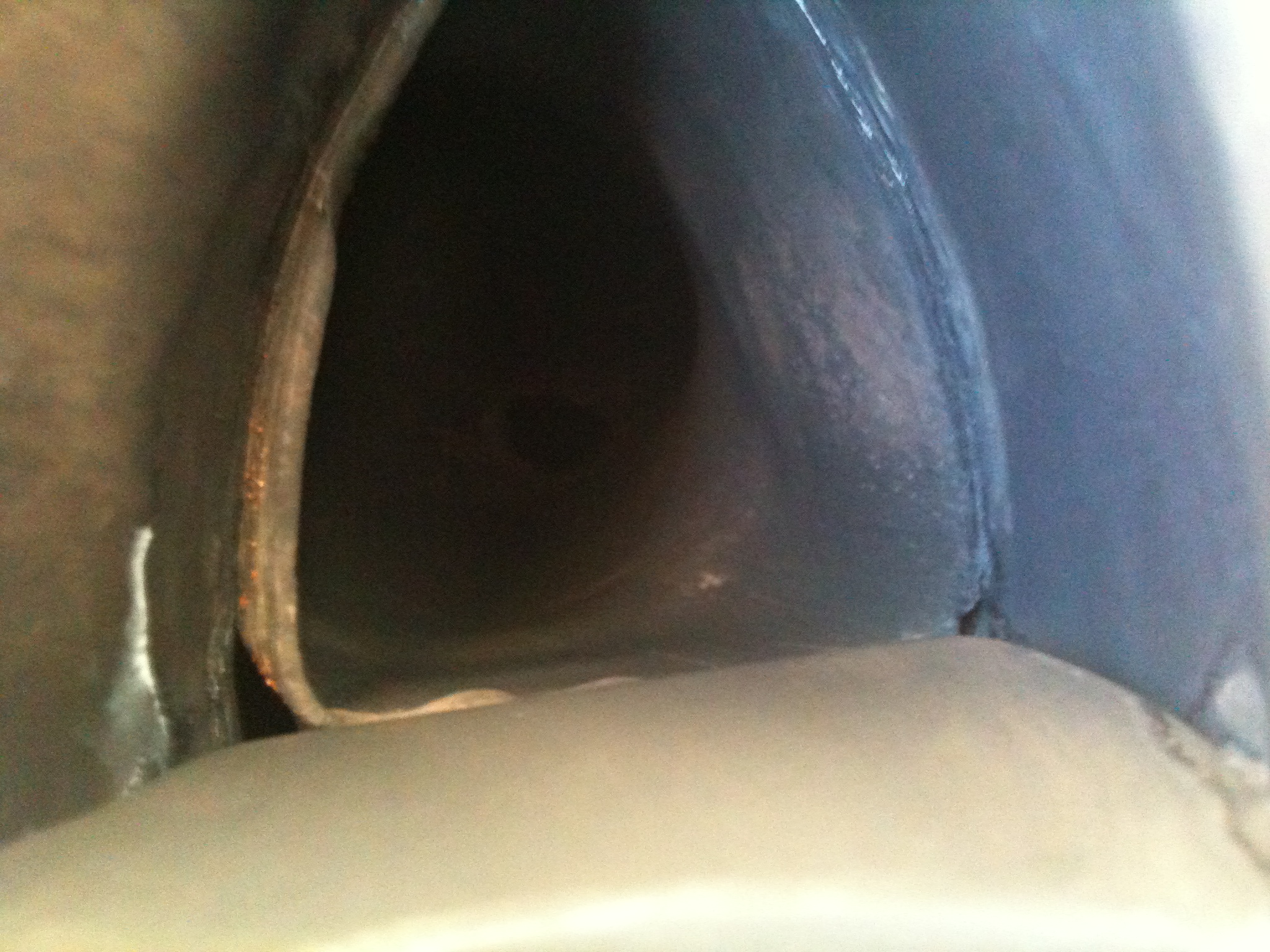

It this case look for Pedro muffler mod; worked for me on the 2.7 - 2 x 1 inch holes each side. I'll get a pic soon.
No investment.

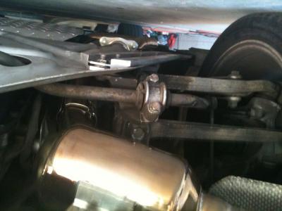

sorry - only one hole each side. also you can see the header and midpipes. The skidplate obstructs the view a little
