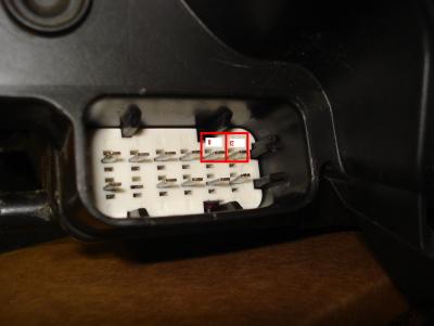

Today, after Thanksgiving meal, I wandered out to the garage for some more troubleshooting. I put the headlamp on my work bench and extended it again with the 10 foot leads that I made.
This time, instead of connecting the wires from the car to pins 11 & 12 (PICTURE #1) to the normal male connector, I bypassed the connector and went directly to the ballast input (PICTURE #2), started the car, turned on the switch and the low beam comes on and works PERFECTLY 10 times in a row.
So, the issue is somewhere between pin 11/12 and where it enters the input side of the ballast.

IT's FIXED!!!!!!
Today I set out to dig deep in to the headlamp assembly itself and discovered that at pin 12 on the main socket, there was supposed to be a ground that provided a ground to the low beam, high beam and the flapper. Got in there with the ohm meter and discovered that it had some resistance, more than normal, so I pinned out the other two ground points (Pin 6 and Pin 2) and they read perfectly. Sooooooooo, I went to fixing it, soldered all new connections and made the repair. WORKS PERFECTLY NOW!!!!
