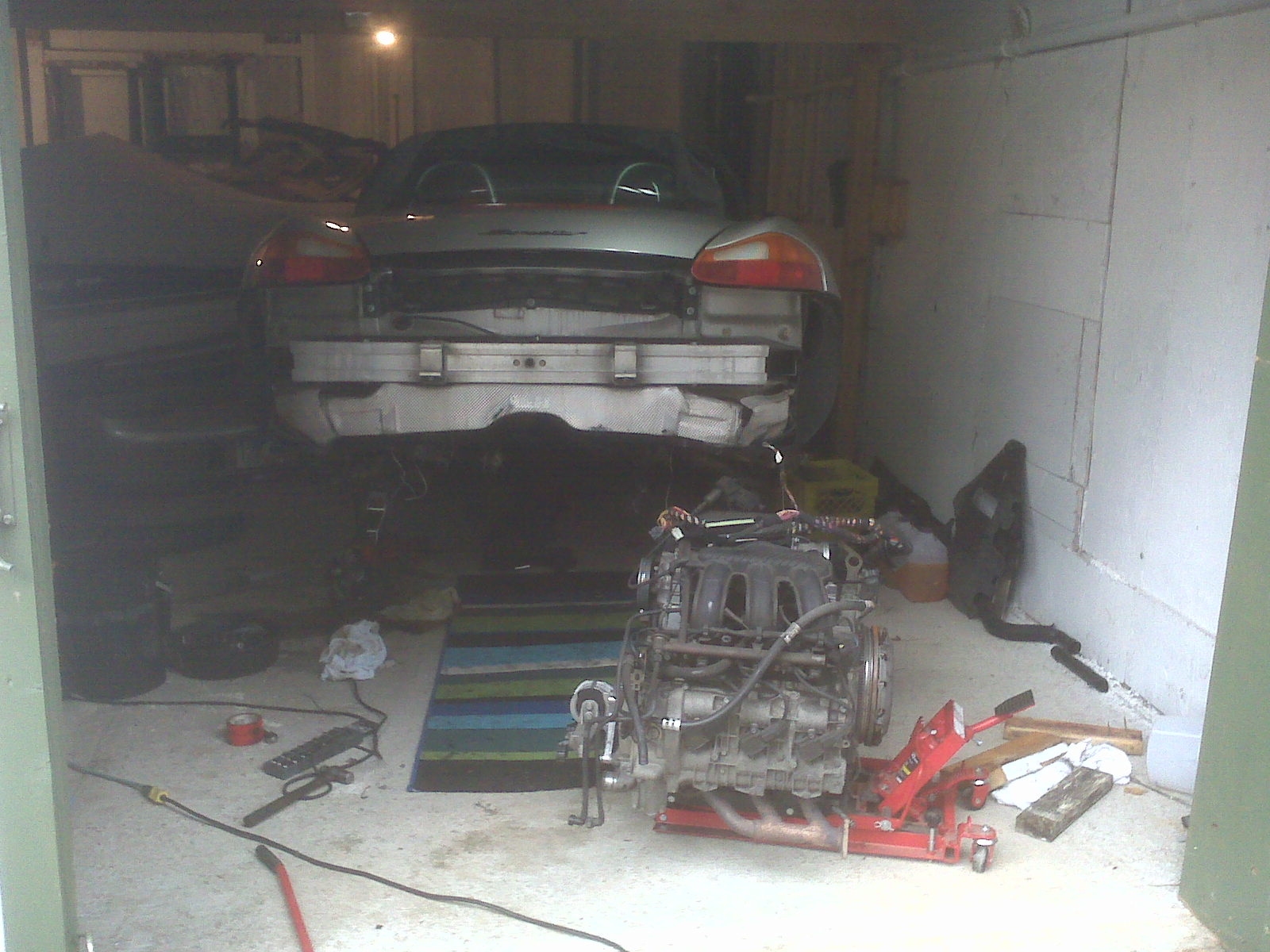

Engine and tranny are out, actually not too bad, getting the car high enough to slide it out from underneath is the tough part. Parts on order from Sunset include vario cam wear shoes, camshaft timing chains, AOS, numerous hoses and seals and clutch kit. Total was about $800.00 or so.
Engine is on a stand and it is much easier to work on...

I discovered my misfire issue was due to 0 compression in #4 cylinder today. I'm guessing I have a bad valve problem and I need to remove the head. So, I too will be dropping my 986 engine this week for Thanksgiving. I also plan to use jack stands in the rear. Too bad, I just replaced the cam solenoid on the other side last month with engine in the car. Would have been much easier now.
Did you use 2 jack stands on the rear of the car?
How high did you need the clearance to be?
Did you remove the bumper and muffler or was the car high enough.
I plan to document the process and post for all, but I'm sure I may be asking for some tips and tricks along the way

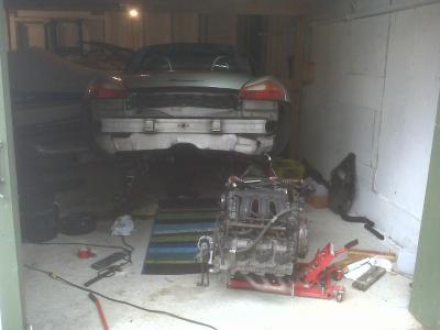

A picture is worth a thousand words...(bumper,tranny,muffler all off) made a custom bridge assembly to hold the engine while I removed transmission, and then lowered engine onto a motorcycle style scissor jack and slid it out.

You do not need to disconnect the lines. Take off the belt, undo the 3 compressor mounting bolts and slide it out as you lower the motor.
If you removed the actual aluminum bumper with its associated heat shield you do not need to lift the rear of the car as high. After removing the plastic bumper cover it is only held on by two bolts.
Also the transmission does not need to be removed before removing the motor, it is easier to drop as an assembly.

Actually the height is needed to get the intake manifolds to barely pass under the stabilizer or aluminum support chanel bolts. These pieces are removed, however the mounting studs
are still there...and in the way. I would not try it the first time without dropping the tranny. My tranny was quite grungy and needed a good cleaning anyway. If memory serves the shift cables pull off easily and the slave cylinder can be detached without losing any fluid. All that's left is the mounting bolts for the tranny mounts and the reverse light switch. With tranny out there is much more room to work. IMO of course..
Also the a/c unit is easy to remove while LOWERING the engine...Lower it bit and it slides right out and into the cockpit with lines attached...
