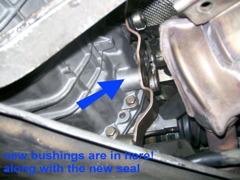

I have a leak where the transmission linkage connects to the transmission. I understand this is a relatively common phenomenon. I am seeking your help in finding a place that will repair it. Specifically, I understand that there are those who make the repair with a brass bushing, which is supposedly superior to the Porsche repair, which is to merely replace the original bushing with the same defective material. If I am going to spend the money, which looks to be inevitable, then I would most appreciate your help in finding a shop in Los Angeles that would do the best possible job.
I have enclosed a link to a photo that indicates where my leak is located.
http://www.renntech.org/forums/uploads/downloadedimages/100_0127.jpg
