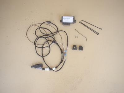

If you buy just the headlights then you just put them in and they will work. If you do not have the separate control unit connected then you will not get the low beam rotation. You can buy the control unit and the wiring harness, and that is in the pic. The control unit mounts in the trunk behind the carpet.
just as TP said, if you just have the lights and want the "rotating" light feature to work you need the harness kit as well. It's a fairly simply install as well. I have seen the kits on eBay go for about 150 or so. The believe the part number for the kit is 996 612 988 00.

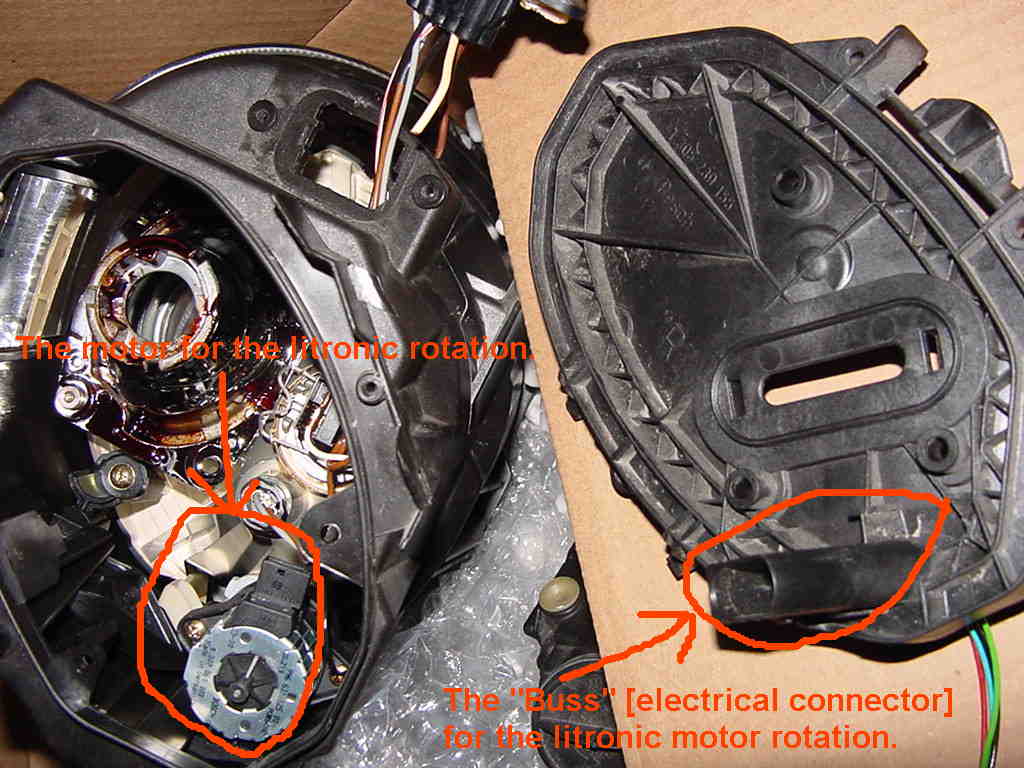

All you need is the wiring harness which was sold on ebay the other day, those appear to be whole units, which you asked about.
Then splice and go, litronics have two busses :eek: for you two plug into where the stock clear or amber mix has a single buss.
;) Scott
