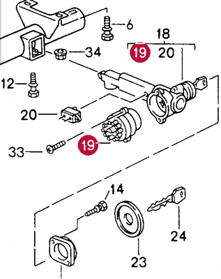

How to do get to the ignition switch on a 1996 993? any one have suggestions before I start taking everything apart?
I have the classic symptoms - A/C problems, door alarms working sporatically, locks no always activating. All depends on how I shut the key off. I have a replacement ignition switch. How do you recommend I install? Any tricks or things to know?

Looks like two screws from the back side.

Guess my real question is how to get access to the back of the unit to remove the screws and replace. Do I drop the steering column or remove a dashboard section. Since the back of the dash is pretty tightly packed, I am hope there is a "Porsche way" of getting to is without dismantling the dash. I appreciate your prompt response with the information above, hope you have some thoughts and guidance on accessing switch. Thanks, DM
On the later modeles there is a lower dash panel or dict that needs to be removed. Then you kind of have to position yourself under the dash and reach the screws.
