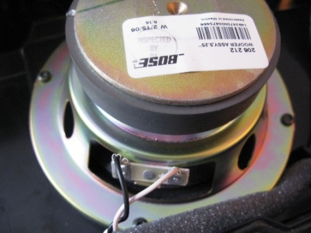

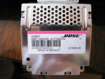

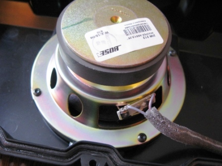

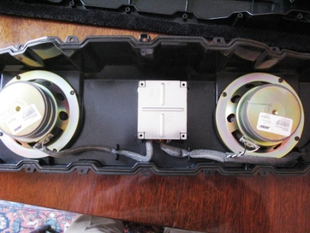

Could someone please help in advising how to use the stock Bose subwoofer amplifier (100WSR) that is fitted inside the 997 rear shelf subwoofer box WITHOUT the complete Bose sound system. In other words i want to hook the Bose subwoofer amp up to existing speaker outputs.
The terminals on the Bose subwoofer amp are:
GND (connected to the same pin as the other GND)
SWB+
IN+2 (empty)
IN+1
IN-1
VCC (connected to the same pin as the other VCC)
SPKR+ (goes to subwoofer 1+)
SPKR- (goes to subwoofer 1-)
SPKR+ (goes to subwoofer 2+)
SPKR- (goes to subwoofer 2-)
So, there are 12 pins on the subwoofer amp, one of which is not connected. Of the 11 pins, 2 are connected to another 2. And four go to the two loudspeakers. This makes a total of 5 connectors on the cable that plugs into the car's sound system. These 5 are GND, SWB+, IN+1, IN-2, and VCC. I would gues that two are power, one is right, one is left, and one is sound common. Is this right and, if so, which is which?

Thanks for the reply. Actually, I'm talking about the subwoofer box itself. And it looks like I'd first have to remove the small 3X5" speakers (with the Bose logos) from the carpeted box. Would I pry those loose using the credit card? Apparently, there's something loose and rattling around inside the plastic subwoofer housing, and I wanna get at it.
The speakers inside the carpeted subwoofer box simply unscrew. The fun bit is opening up the box itself, which is in two halves, and held together i swear with about 1,000 screws around the edge! you will need a torx screwdriver with a long shank and lots of patience! Once you open up the subwoofer box its easy to see if there's anything inside that's rattling around. But before you ipen up the subwoofer box, check to see if the trim bezels around the speaker vent outlets are loose. Mine were.
