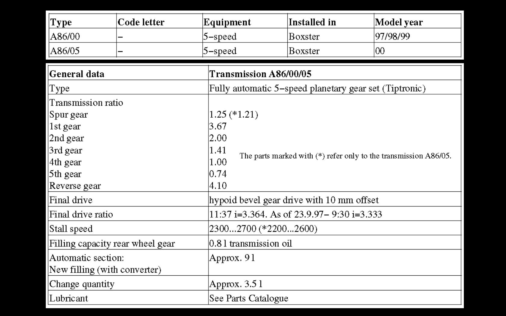

to answer your 2nd question see attached pix to get some idea
I have MY03 and it has the A8605-150 ZF 5-19FL (not sure what the 150 stands for)
so I'm not really sure 100% of the technicality of using other model transmissions into yours but I don't see why not except for what you need to
change whether mechanically or electronically (as far as ECU). If you want to go that route I would take a look at the difference mechnically then
deal with the ecu afterwards.
