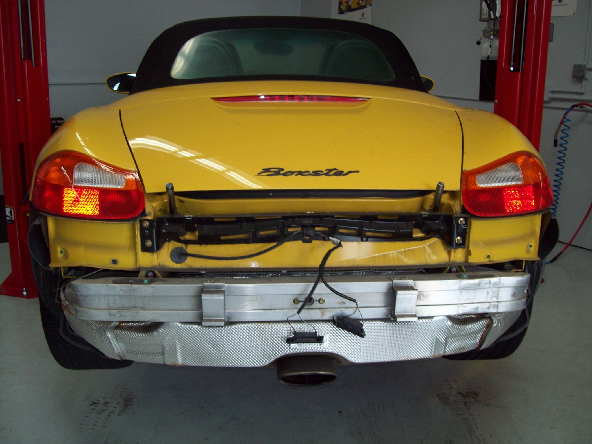

I have the same problem. Fuse is ok. Dash lights ok. No voltage at light bulbs. I would rather rectify the problem than start bodging the wiring. Anyone got any ideas?
Cheers - Matt.
Check the connector behind the rear bumper, if the bumper ever was removed.
I have a picture of the lights with the bumper cover off, but I did not pay attention to any connector back there. The lights have a BMW logo on them....
Remove the bumper, the connector is visible on Tool Pants pic. besides the wire label, attached on the black spoiler reinforcement.

Finally got round to fixing this today. Fed some new wires through the grommet in the boot (Rear trunk) and snipped old feed and soldered them in. Then did same at other end and soldered them to the lights. Thanks for your help everyone! :)
Cheers - Matt.
