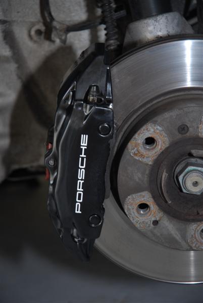

Here is the little hack that i did today. 1 down 3 to go.
Bead blasted the caliper, taped off the important parts, shot with 2 coats of black gloss powder, put on sticker, the applied one layer of clear gloss.
I like the boxster instead of Porsche on it. Kinda one of a kind.
