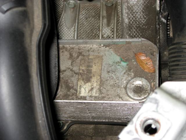

post-28317-1259001844_thumb.jpgThanks for your help and suggestions. I got into the work a bit yesterday, but mostly just looking around. I have added a picture of the oil cooler here. Anything jump out as something wrong?
Is there an easy way to check the water pump? I am assuming there may be something wrong with it based on the operating temperature when I was running it yesterday. It ran in normal range (just above 180) for about 30 minutes. Then, it started going up pretty quickly after that. It ended up hitting about 215 before the secondary cooling fan kicked it, which then cooled it back off. Since I wasn't driving anywhere, just sitting. I think this points to the water pump since it had absolutely no help from moving air that would be there during a drive.

Thanks for the help. I will replace the oil cooler and water pump as soon as I can. These seem to be pretty straightforward DIYs from what I've read on this forum. Probably next year unless I run into some free time (and $) soon. Holidays, baby on the way, don't see a lot of tinkering time (or $) in the future.
