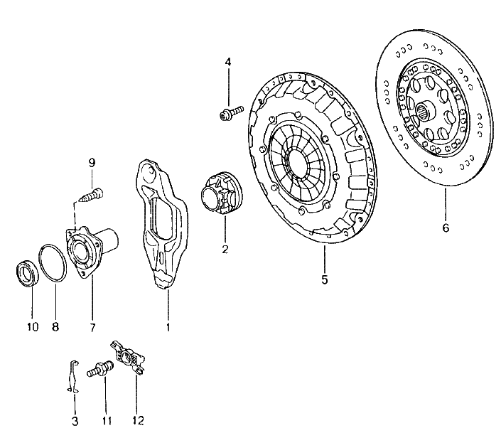

I have removed the clutch pressure plate/disk and flywheel to put my engine on the stand. Unfortunately I did not mark or note which side of the disk faced the flywheel. I understand this makes a difference and may lead to problems upon reassembly. So my question is - can you figure out by looking at the disk which side is which? If not should I just bite the bullet and put in a new clutch?

What exactly do you mean by the flat portion of the disk? The inner metal portion of the disk is everted on one side and inverted on the other. It looks to me that the everted side would face/fit into the pressure plate side, what do you think?
