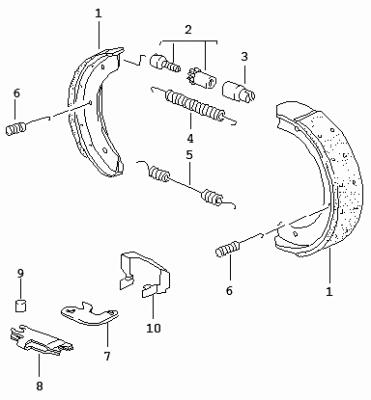

exposed the rear break after removing rotor. The large spring was a mangaled. Now I need to find schematic with a part number??
no the noise was coming from the springs getting beat up. now there are only four in the states two in Atlanta and two in Texas
Pull the other side to figure out the way it is supposed to look. It seems to me that the spring must be compatible with something, have you tried the wrecking yards.
Maybe a brake place that does Porsche brakes, they might have an old one sitting around, is there anyway to heat up yours and bend it to the shape you need as a temporary fix. If it is not to mangled.
I can give a wrecking yard a call on Monday that deals with Boxsters if you want me too.
Can you post a digital shot for me to compare to if I find it.
Scott
Both sides are trashed. I will try to find one at a yard local I assume there must not be much difference between that spring and many others.
