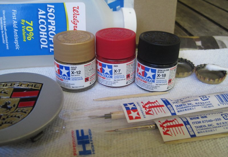

My order:
Acrylic Mini X-18Semi Gl Black - 10ml Bottle Item# 81518 $2.30
Acrylic Mini X-7 Red - 10ml Bottle Item# 81507 $2.30
Acrylic Mini X-12 Gold Leaf - 10ml Bottle Item# 81512 $2.30
Pointed Brush Med - DC716 Item# 87016 $2.50
High Finish Pointed Brush - (Ultra Fine) Item# 87048 $5.25
Shipping: $6.00
I used the pointed medium brush for the flat areas, and the ultra fine brush AND a toothpick for the letters and detail areas, like the horse legs. If you are careful with the gold and red, you can use the black just for touch-up. I only painted black where it was necessary, and left the factory black in the other areas. A magnifying glass helped, too. I put a small amount of paint in a beer bottle cap for dipping, and some isopropyl alcohol in a second cap to clean brushes. I thinned the black paint with a few drops of isopropyl alcohol also, but not the gold or red. You can also clean the brushes with water.
If you mess up, you can clean up mistakes using a clean toothpick or a q-tip. It's best to do the gold and red, then let it dry overnight before doing the black touch-up work. I also did one cap start to finish before doing the other three. The second set came out better, since I had practice.

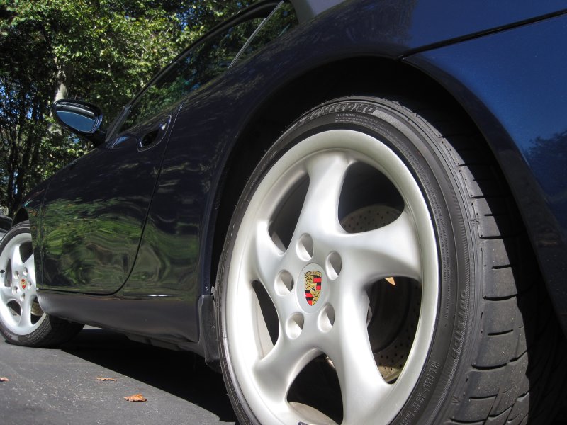

Finished painted wheel center cap:
post-56687-001346300 1284843767_thumb.jp
Paints used:
post-56687-065313200 1284843764_thumb.jp
Tamiya Med Pointed Brush 86016, Ultra-Fine Brush 87048, and a toothpick:
post-56687-033433000 1284843765_thumb.jp

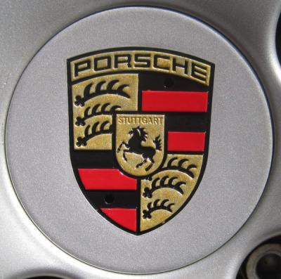

Finished wheel center crests:
post-56687-018086200 1284843766_thumb.jp

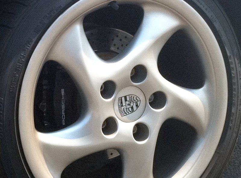

Before painting:
post-56687-085563400 1284846316_thumb.jp
