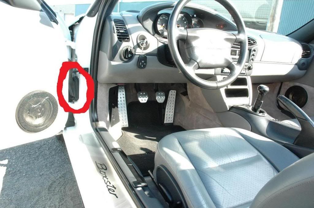

There is a black junction box where the door hinges are, this box has male and female plugs in there, open it up and check to see if the pins are corroded.
If they are corroded find a way to clean, fix or replace them.
I would start with that.

Pulled black box connection apart, wires and connectors are as new. Still have di-electric grease on them and no signs of moisture.
With the drivers side door connection pulled apart the defrost light was still on. What's next?
