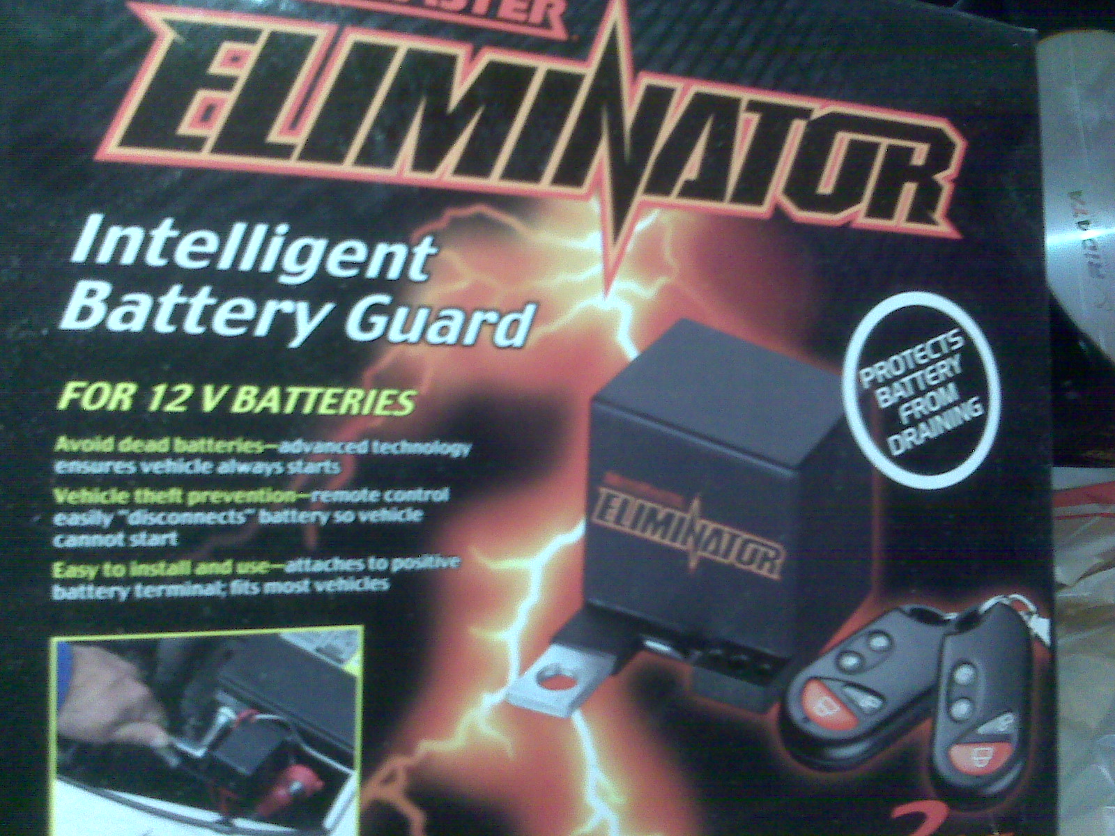

I realized that my charger had an option for 2A charging current for that purpose. I will consider charge it up once a month during the winter time. Beside, I am planning to install a battery protector soon.
