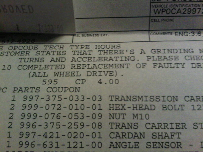

How many miles does your 996 have? What was the bill for this repair? I wonder if this problem is common. My 2003 996 TIP has 18k miles and I get a bit of a low grade hum from the trans when making a right turn at speed. It could be the early stage of this problem?
Yes... I have 55K miles on the odometer.
The repair for JUST transmission mount is probably around $700 but I had a drive shaft problem too so total was $1700.
I don't think it's mileage, it's age. The car is 8 years old and I do track it...
