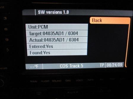

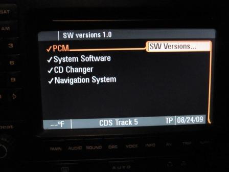

Try pressing the MAIN and TRIP buttons together and the version number should show in the top left of the screen. And you can search on Renntech.org for a lot more info -- both the CD and DVD versions of PCM.

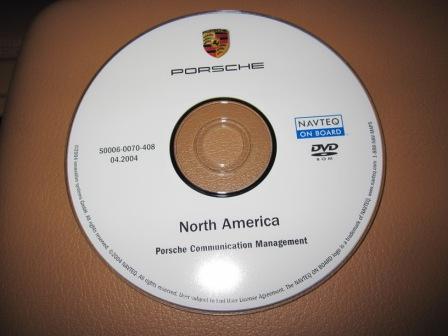

Thanks for your post... I did the Main and Trip button and it shows SW Version 1.0. Does this mean I have PCM ver. 1.0. My PCM comes with a DVD NAV. I am attaching some pictures of my PCM for ref.
As far as I know CD-based is PCM 2.0, DVD without touchscreen is PCM 2.1, touchscreen is PCM 3.0. Software/firmware version does not necessarily correspond to PCM version. Be sure to check out the TSB's under the Cayenne section on this site -- search for PCM. You may want to update your PCM's operating system software/firmware.
