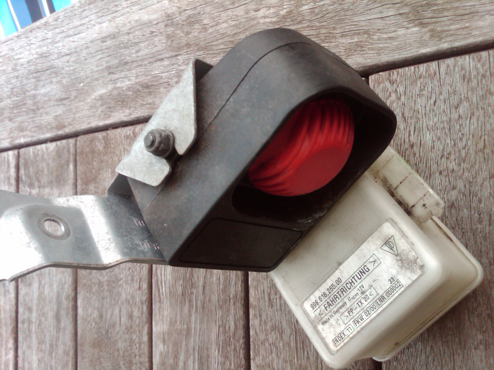

I got the alarm unit out. It is indeed the battery that's the problem. There is corrosion in the battery socket where the connector fits. If I rock the socket extremely gently the alarm goes off.
The battery is on a bracket. It is definitely separate to the horn but the bracket attaches next to the main battery. The bracket holds the horn and the battery together.
The part number for the battery for future reference is 996.618.265.00. I will post pics later.

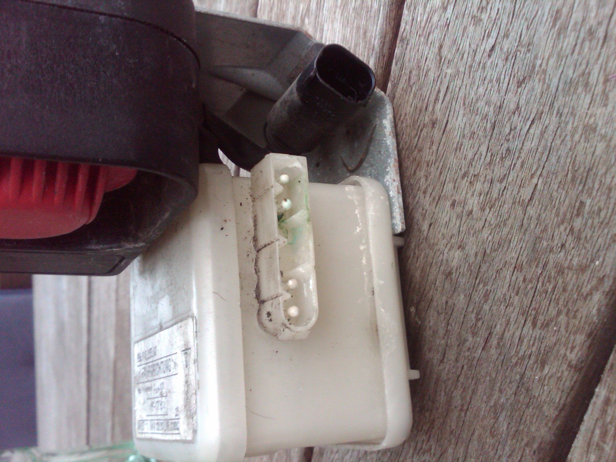

When I look at the pins sticking out the batter where the connector goes, there is battery fluid and it has corroded the pins and connector. Dont suppose anyone knows the part number for the connector?
There are two connectors. One is black and oval sort of shaped. That's for the horn. The other is an orange flat connector about 2 inch across. Its the orange one I need.
That isn't the battery - it is the tilt sensor. They fill up with water and that's what is causing your problem - it is really common. The later type tilt sensor can be retrofitted, which goes under the (UK) passenger seat. I believe there is a TSB, or it may be in the workshop manual.
Edit: It's in the workshop Manual - 96 64 32 "Converting installation position for tilt sensor, additional alarm system M536"
Well blow me!
And here's me thinking it is a battery. Is there in fact a separate battery for the alarm as Tech9 told me?
Many thanks Richard.
The backup battery is inside the siren, but I don't believe that's the cause of your problem. I've never taken a siren apart, so I can't say if the battery is changeable, but I have never known one to go bad.
If you have water inside the tilt sensor, it will likely be shorting out somewhere inside. That will be what's causing the false alarms. I know a couple of people who have tried drying them out without success.
