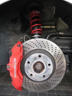

If this is of any help, I did my conversion with GT2 front wheel carriers and 997 turbo discs and calipers for front, 996 turbo discs and calipers for rear. Rear is a direct bolt-on, fronts almost with those wheel carriers. Just one issue, you'll need 1.5 mm spacers between hubs and discs to get front discs centered to calipers. Local Porsche Centre did the installation. No need for diffferent master cylider or brake bias valve. Works fine, I've done several track days without issues.
When I measured different brake combos for my past project, a 951, I noticed that while 996 turbo and mkI GT3 share front calipers, their discs have different offset ( again that very same 1.5mm, the difference is in the wheel carrier/hub ), so try to use dedicated discs/calipers/wheel carriers. Or get shims like I did. For 951 the solution was easy, just machine adapters accordingly. I ended up using GT3 mkII stuff in all four corners...
