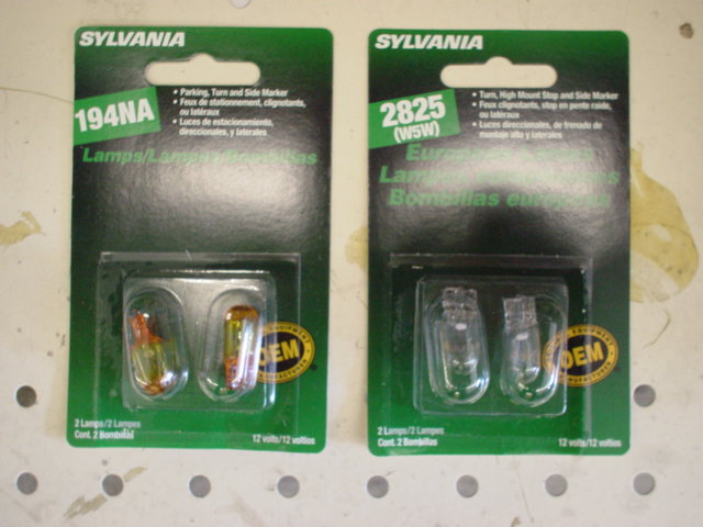

Recently, I changed the sidelights on my 996 C4S from U.S. amber/white light to European clear/amber light. Only after changing the bulbs did I see in the owner's manual never to touch the bulbs with bare hands to prevent any grease on the bulbs. :oops:
My questions are:
1. What is the worse case scenario if I did get fingerprints on the bulb?
2. Can anything be damaged?
3. Should I preemtively replace the current amber bulb with a new one being very careful only not to handle the bulb with my bare hand?
4. Does anyone have the part number for replacement amber side light bulbs?
Thank you for your help!

Find something else to worry about. I have been changing incandescent bults on cars, motorcycles, and motorcycles for years with my greasy fingers. I know what it says in the owners manual, but don't they also say to use only Porsche approved air in your tires. Next it will be to wear gloves when you change a table lamp bulb.
Halogen bulbs are different since they burn much hotter. Those bulbs I do not touch. But if they have dirt on them then you simply clean it off.
The clear and amber bulbs can be found at any decent parts place.
I agree with Tool Pants -- you are worrying too much. It is no big deal if you get grease on halogen bulbs, you can easily wipe them down with alcohol. I use wet naps like the ones you get from a restaurant when you order baby back ribs. ;)
Edited by programmatore
I agree with the others, I wouldn't worry about it. Worse case scenario (with high temp bulbs), the bulb will just burn out sooner. So if yours burns out, just don't touch the new bulb when you change it.
I'd also just use this as a personal experiment to see if touching the bulb makes a difference.
b-man
I recommend getting the Philip silvervision side markers.
They appear silver, but extrude orange light at night.
White lamps are not DOT approved, they require an orange lens.
One of many websites: GMCPauls
HenryV - which bulbs did you use? That is the bulb I'm looking for. I've found the Porsche oem bulb type (2825 using this bulb resource) but haven't been able to find the Philips equivalent. The GMCPauls site has bulbs but isn't any help in tracking down the equivalent bulb either.
