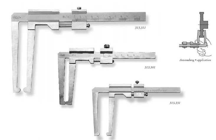

I just bought a Scala 313.301 model brake caliper measuring tool, I do not know how to use it because the instruction are in german. Does any have any experience using this tool?
You should be able to get rotor thickness in mm.
Just put on each side of the rotor and then find the "thinnest" spot. That would be your measurement for acceptable rotor thickness/wear.
Loren, how do I measure the thickness? I do not know how to use it properly! what is the small measuring device on the bottom that is 0-10 is that in cm? and the top scale is that in mm? Thanks
