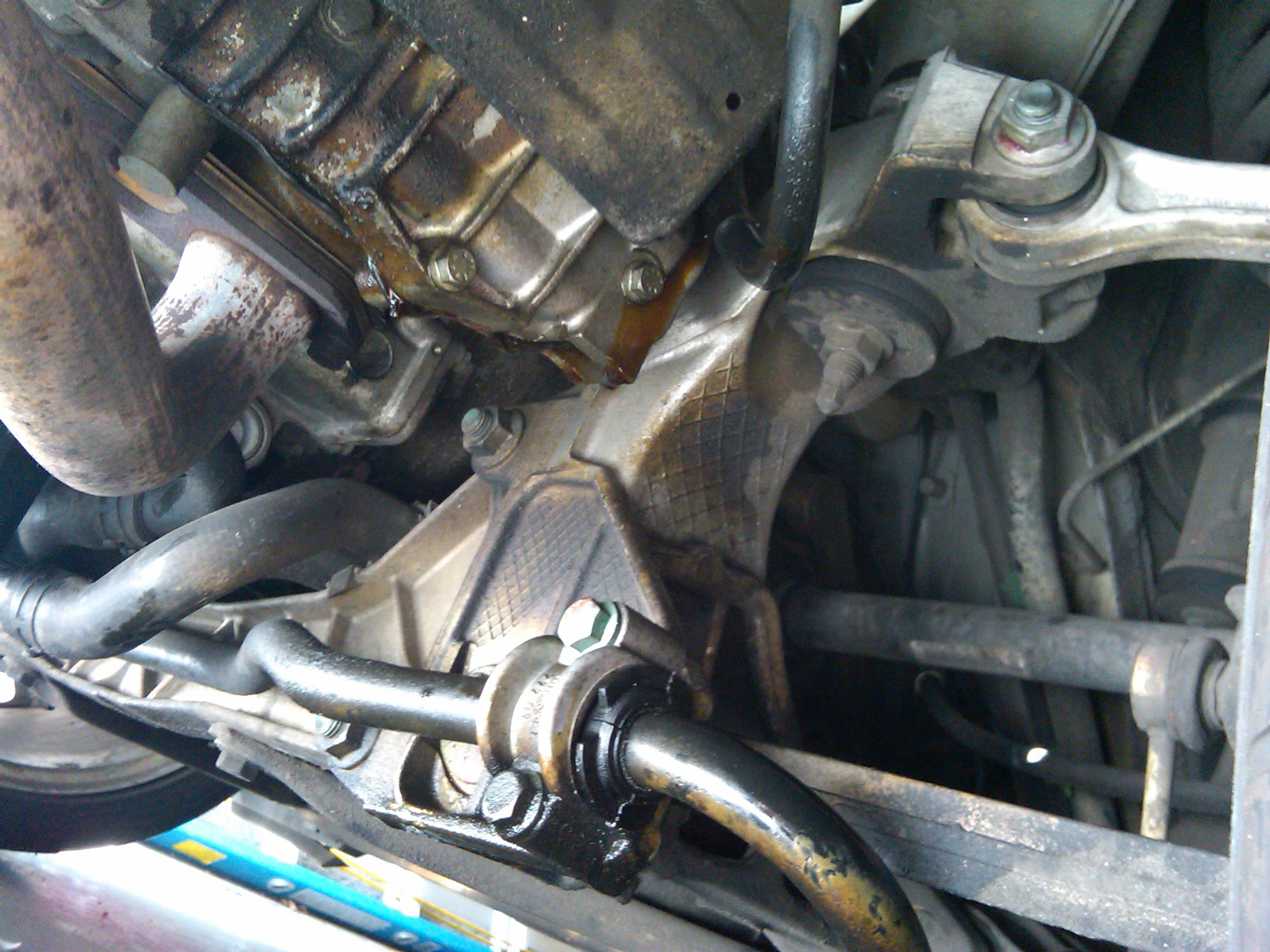

I check fluids. Coolant is fine. So is brake fluid. Nothing showed on the oil dipstick so i started the engine to let it warm up. The drip immediatley started and I took a photo (attached). Turned the engine right off and still got no mearurement on the dipstick. Guess its an oil leak. At 29K miles. Darn it.
So should I flat bed it or add oil and make the 15 mile drive to my mechanic?
If it's noticeably leaking out like that, I wouldn't drive it. You can get away with seeping, but not a big leak.
Looks like it is coming down the side of the cam cover. check the two green plugs on the end of the cover. Also, the oil cooler is mounted on the top of the engine above this location. Hard to see unless you take off the airbox.

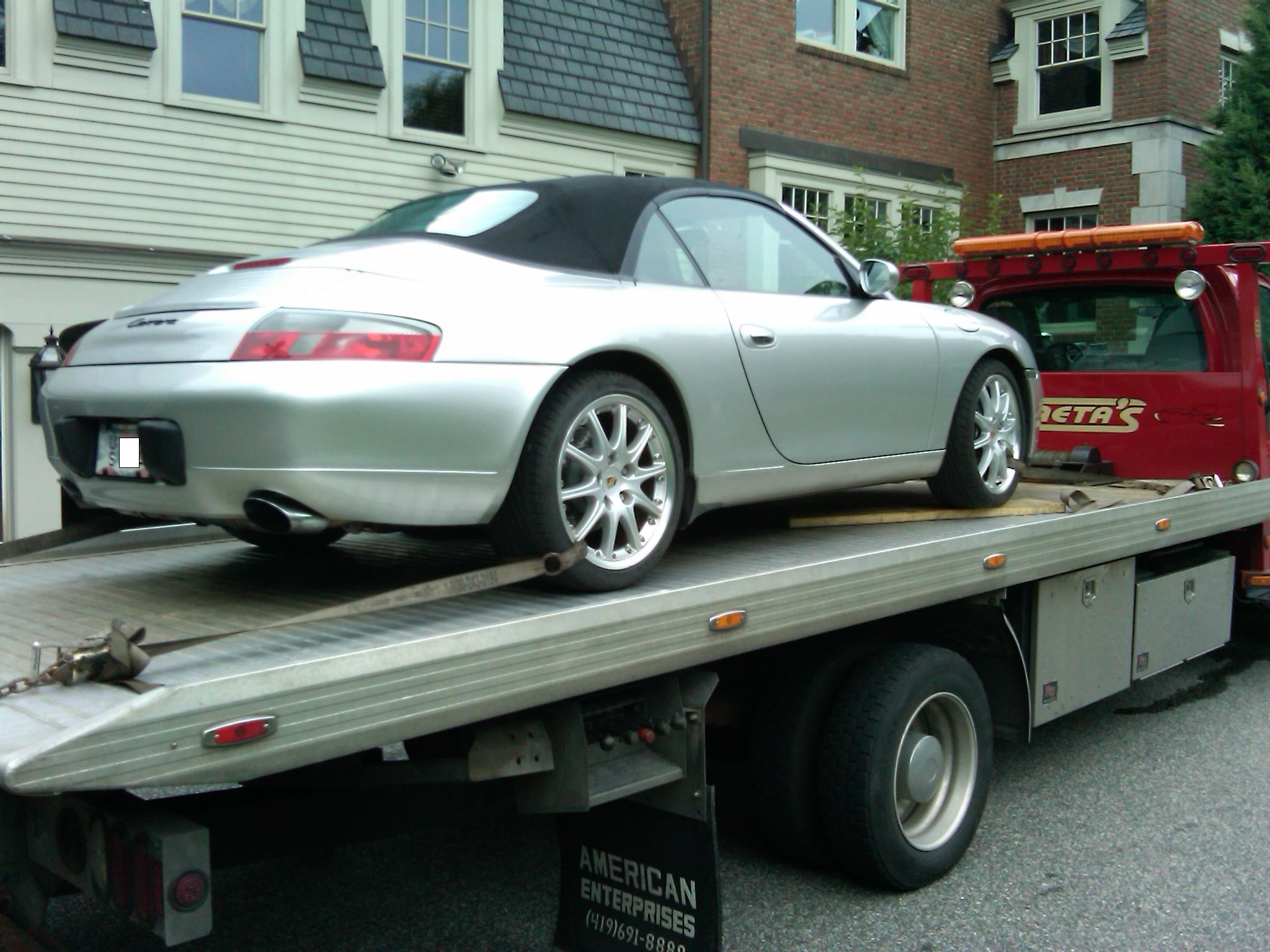

post-2448-1248362895_thumb.jpgIt was leaking steady with engine running, so it was picked up today. $125 to get it towed 15 miles. Cost to repair: Stay tuned.

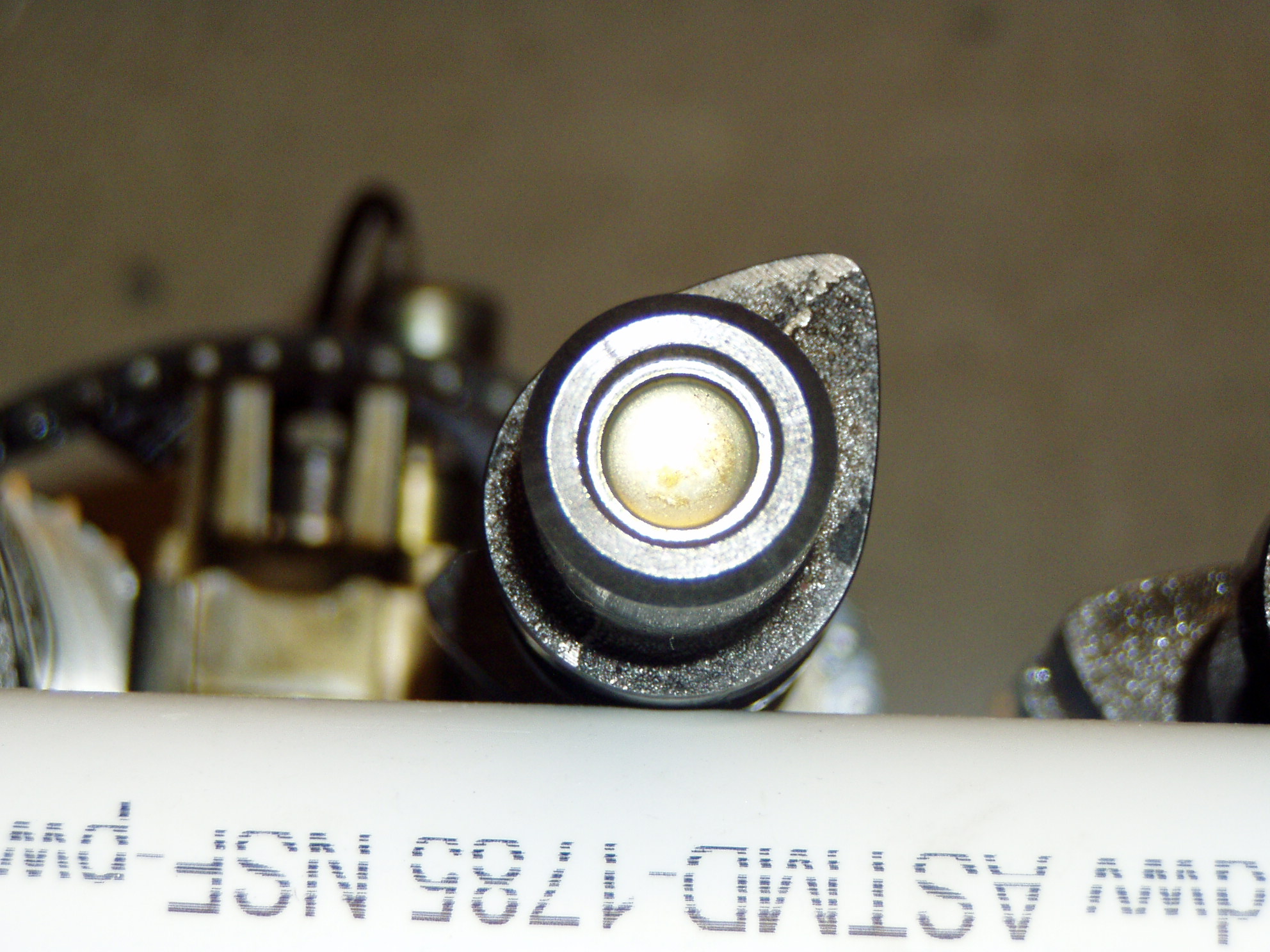

The only thing that would blow these caps out is oil leaking from the camshafts, which are pressurized with oil to feed the cam journals. Look inside the plug hole at the end of the cams. There are expansion plugs, here are a couple of pictures

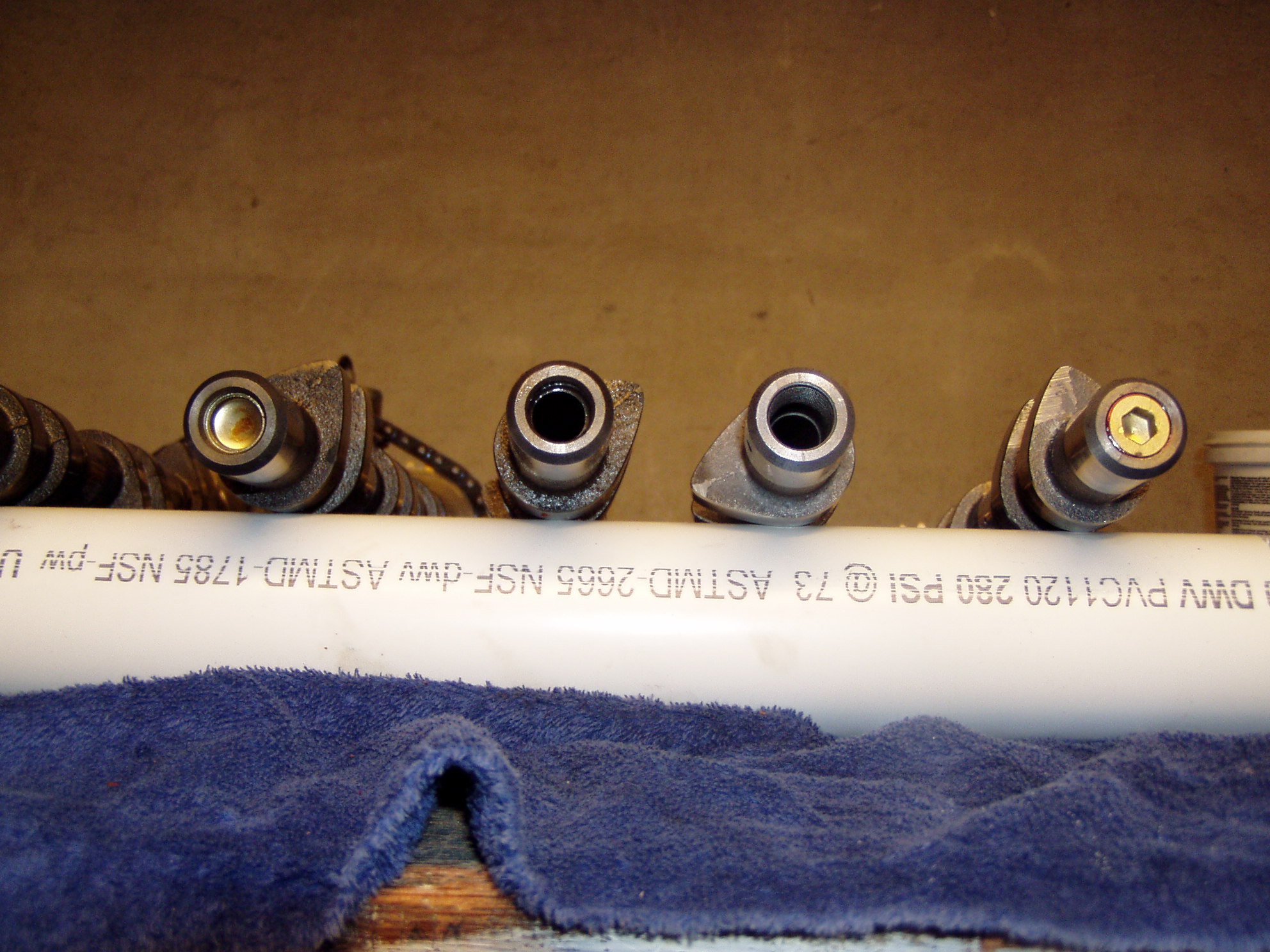

When I reassembled my engine after repairing a cracked head I had one blow out on my 1-3 intake cam. Here is a picture of the cam without the plug

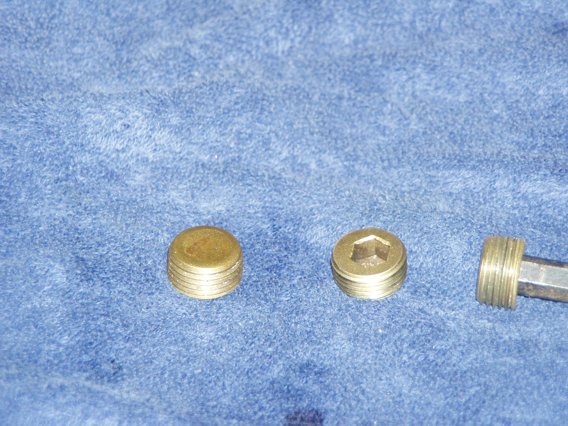

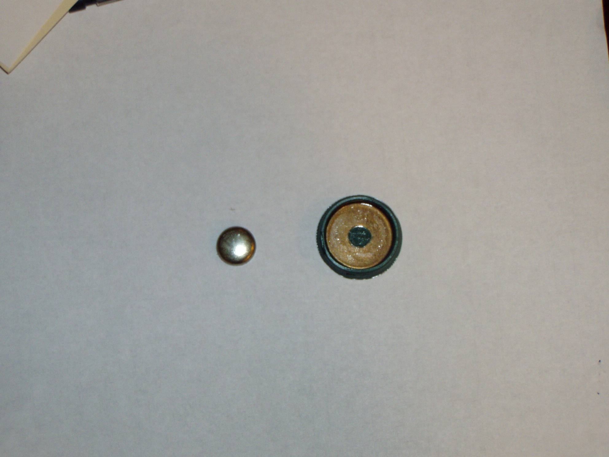

If one is blown out you will definitly see it and oil will pour out of the engine. If the plug is gone you cannot get one the right size to replace it, Porsche won't sell them and all the domestically available plugs are to deep to work, believe me I tried. Here are pictures of the plug and cap
The problem is that the OEM plug is only about .18" deep, and goes up against the shoulder you can see in the picture of the cam with no plug in it. The plug has to go in all the way as the widest part is the top, and it is an interference fit. All the domestic caps are .25+" and so won't go in far enough to fit with property tightness and blow right out.

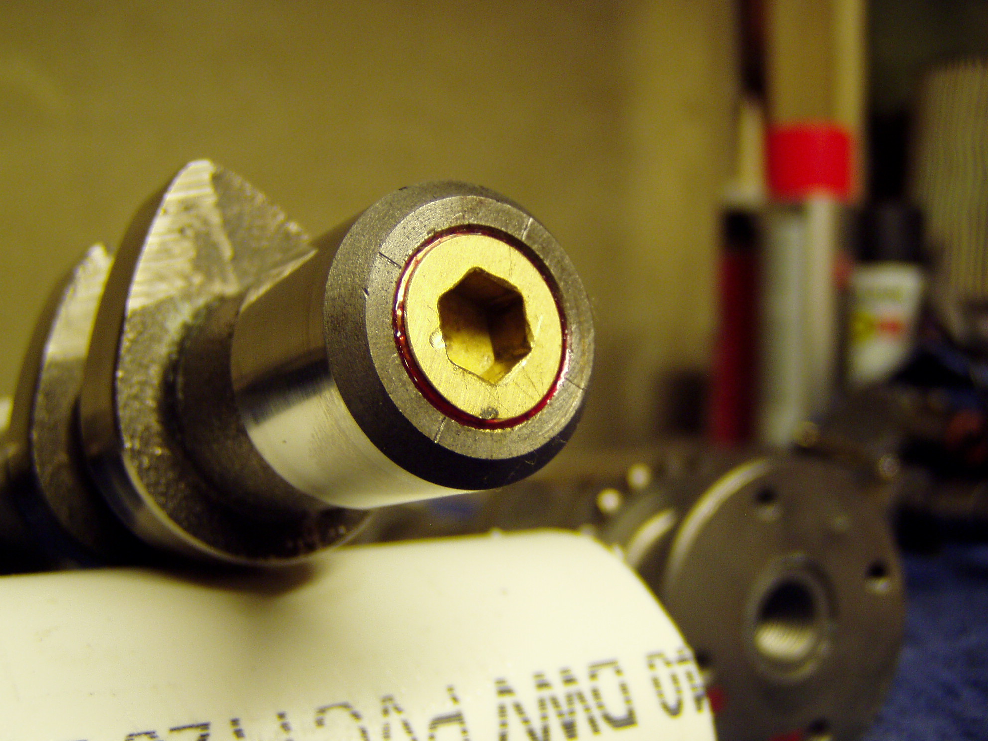

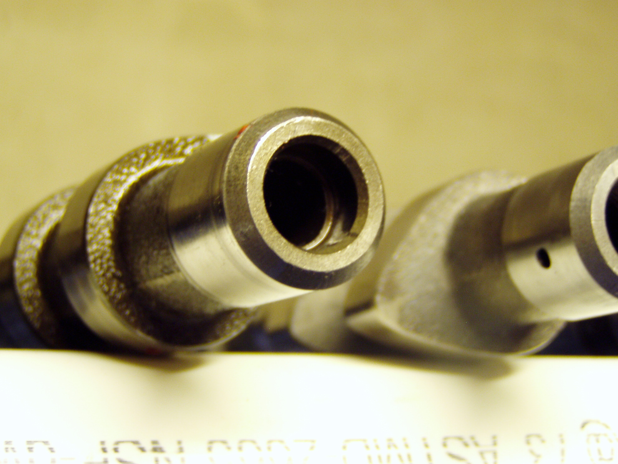

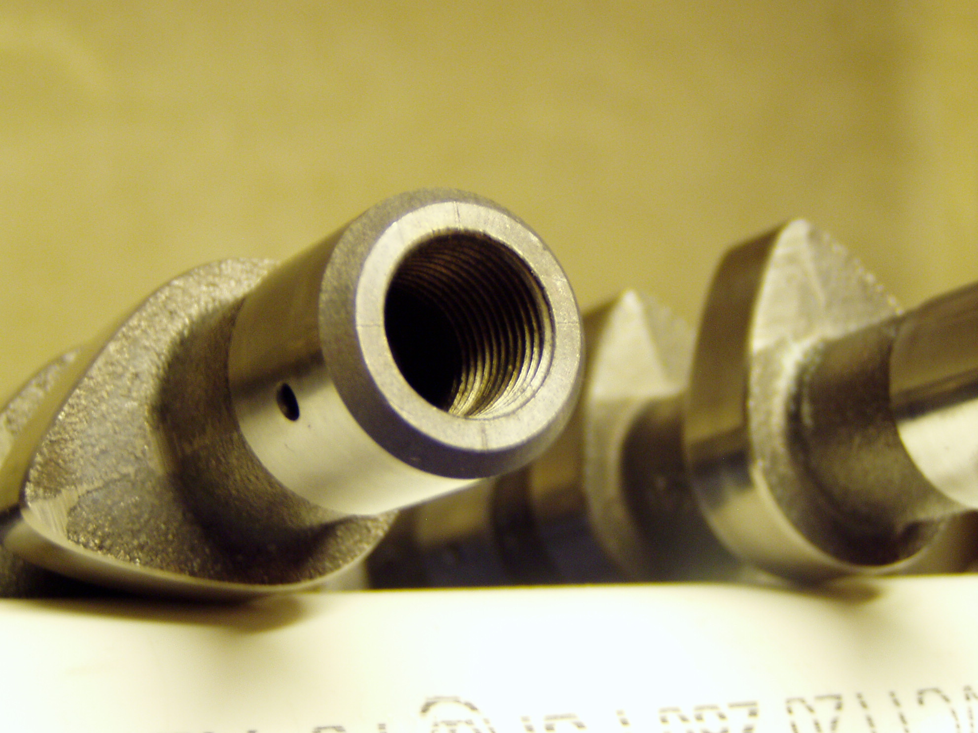

The solution I found is to tap/thread the end of the cams and put in a threaded plug. Here are some pictures of this
See the next post for more info, this has reached the limits for pictures
Edited by Dharn55
OK here are some more pictures of the threaded and plugged cam
I ended up taking out all four of my cams and having both ends of each one threaded and plugged.

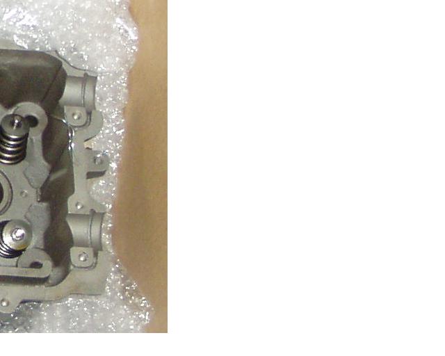

There is another possible problem if the expansion plugs are still in place. The end journal/bearing will have oil pressuring out of it. This oil goes back into the engine through small passages in the head which can bee seen in this picture
If these pasages have somehow become clogged with something, then enough pressure will build up to blow out the plugs without spewing out oil like a missing expansion plug. I guess this could also be a source of the caps coming out/leaking.
