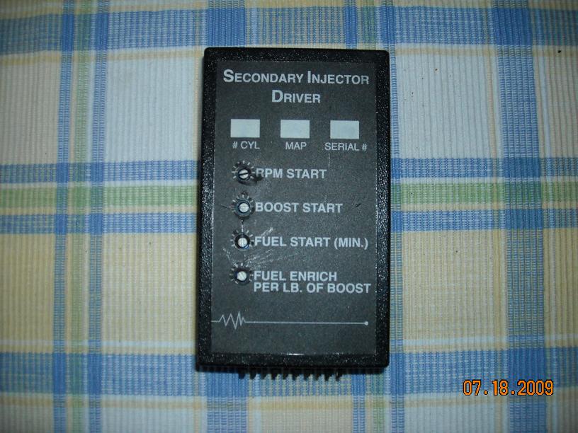

For some reason my blackbox is different from all the rest.

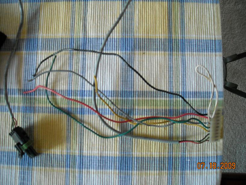

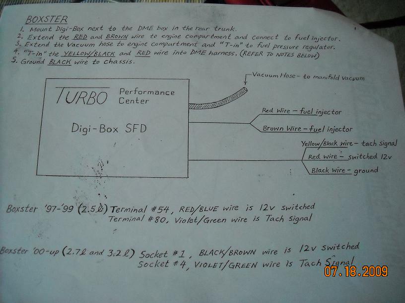

I did the following and the tach would turn off. I disconnect the box and tach would turn on.
Red to 12v (red/blue)
Yellow to Tach (violet/green)
Black to ground
Gray to injector
Green to injector
Edited by jroyse
I hook the yellow wire to the tach wire on the car and the tach stops. I disconnect the yellow and the tach works.
