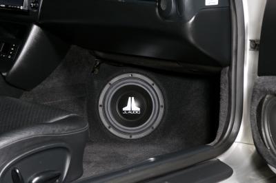

If you want decent bass in the car, just build a small sealed enclosure into the passenger footwell. I am running a JL 8W0 in mine, along with 6 1/2's in the doors (I have Hertz MLK3 system), and even on the highway, top down, the sound in incredible.
See pics.
