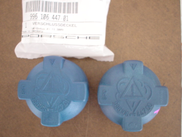

You might simply just have a bad cap. If you went to the cooling tech session in SUNNYVALE a few months ago you would know this.
The cap on the left is the current one. The one on the right is the former one. My old VW cap is not in the picture. The new cap is said to seal better so you do not dump coolant on the ground.
If you already have the 01 cap then ignore what I said.

Read the part number on your cap. If it is not 996 106 447 01 then you need a new cap. $14.71 retail as of Nov 2003.

When in doubt, replace the cap. Like Loren says.
Hey Jeff, I have the Audi/VW cap. I will go ahead and get the new cap.

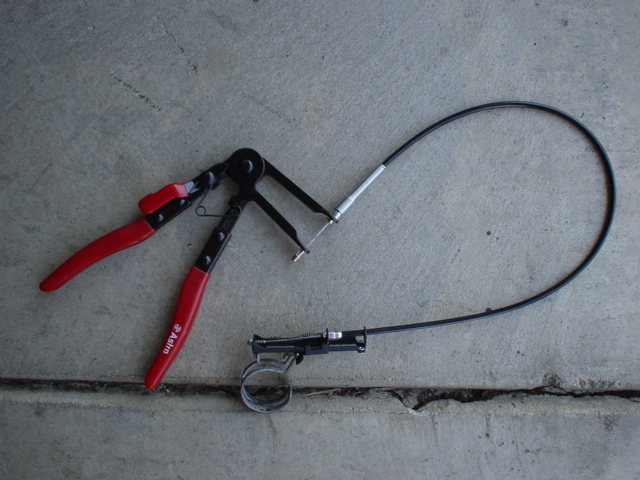

Where did you buy that tool to remove the spring band clamps? That would've saved me a lot of time when I did the water pump on my Explorer.
I'm planning on replacing the water pump on the boxster a few months from now. That looks like a worthwhile tool to have.

Only one clamp for a water pump replacement. I bought it in case I had to replace the plastic tank.
You can borrow it anytime you want.
Guess what, the dealership has the same type tool.
