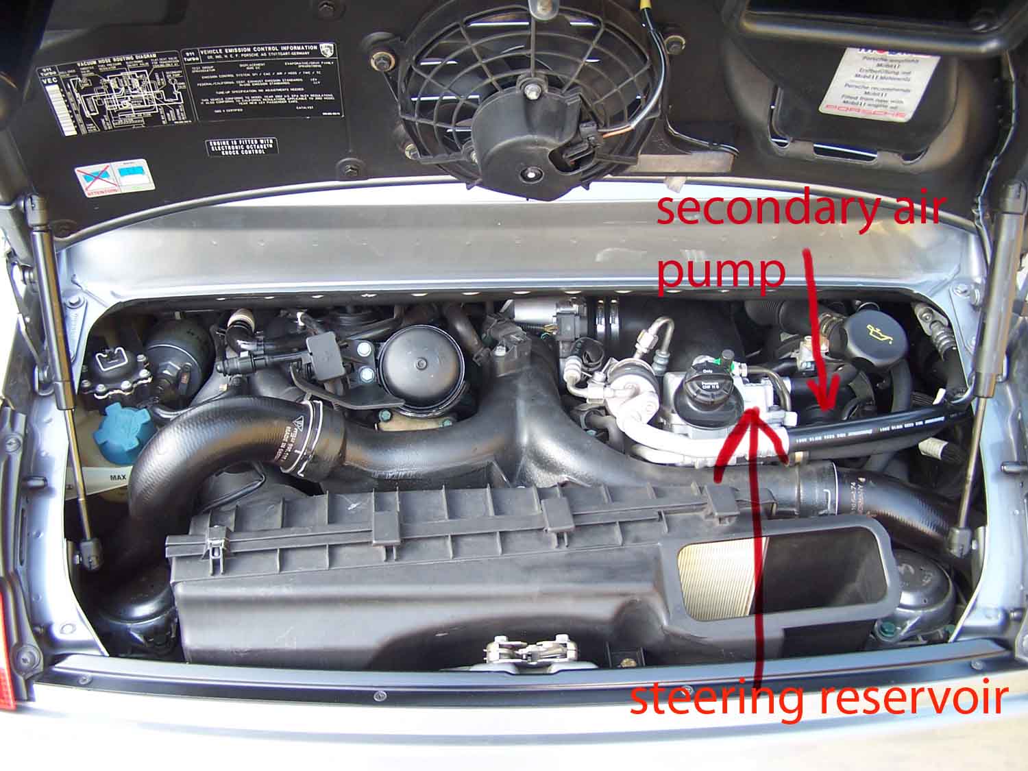

It sounds like a screaming vacuum cleaner that some have described here. What I noticed is the sound stays constant even when engine is warmed up and cruising. It usually goes away as the clutch is depressed when coming to a stop. Once it stayed on even when idling. When I popped open the rear hatch, I think the whining noise is coming from the center. Could it be the steering pump or the secondary air pump that's causing it? When are those components located (center, left, right)?
TIA
You got exactly the problem mention in the TSB #4897 of the 1/05. "TT_Loud_Whistling_Noise_From_the_Engine_Area.pdf" If you got access to the TSB you will get all the info about this problem. It is a pressure control valve within the steering reservoir that is vibrating and causing it to make that noise. You need to replace the reservoir to fix it. 996 314 920 34 ($739.50) looks like it is supersede by 997 314 920 31. Hope this help, J.P.
Thanks. Think that's exactly where the annoying sound is coming from. Hope it won't be too costly to fix.
