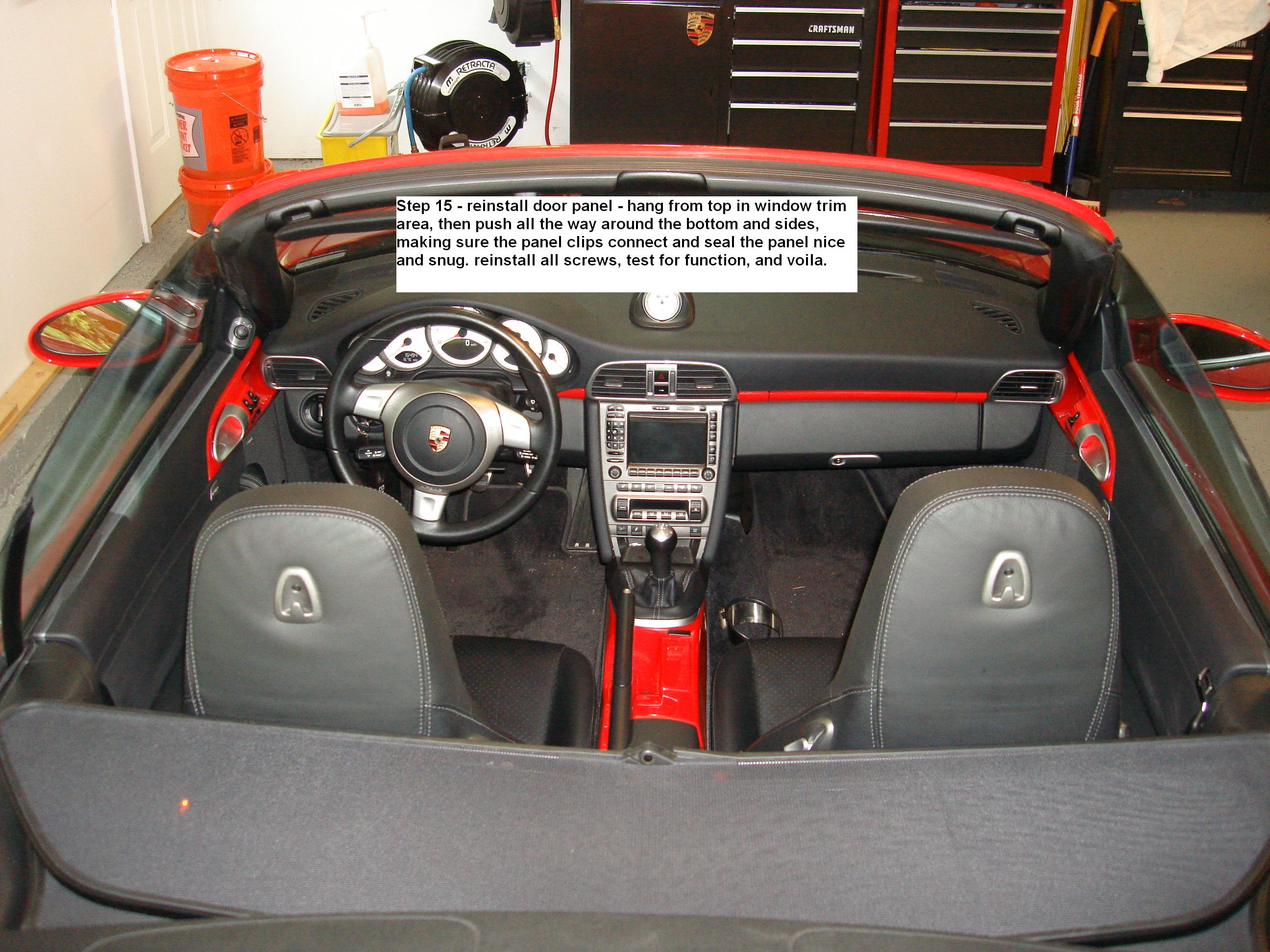

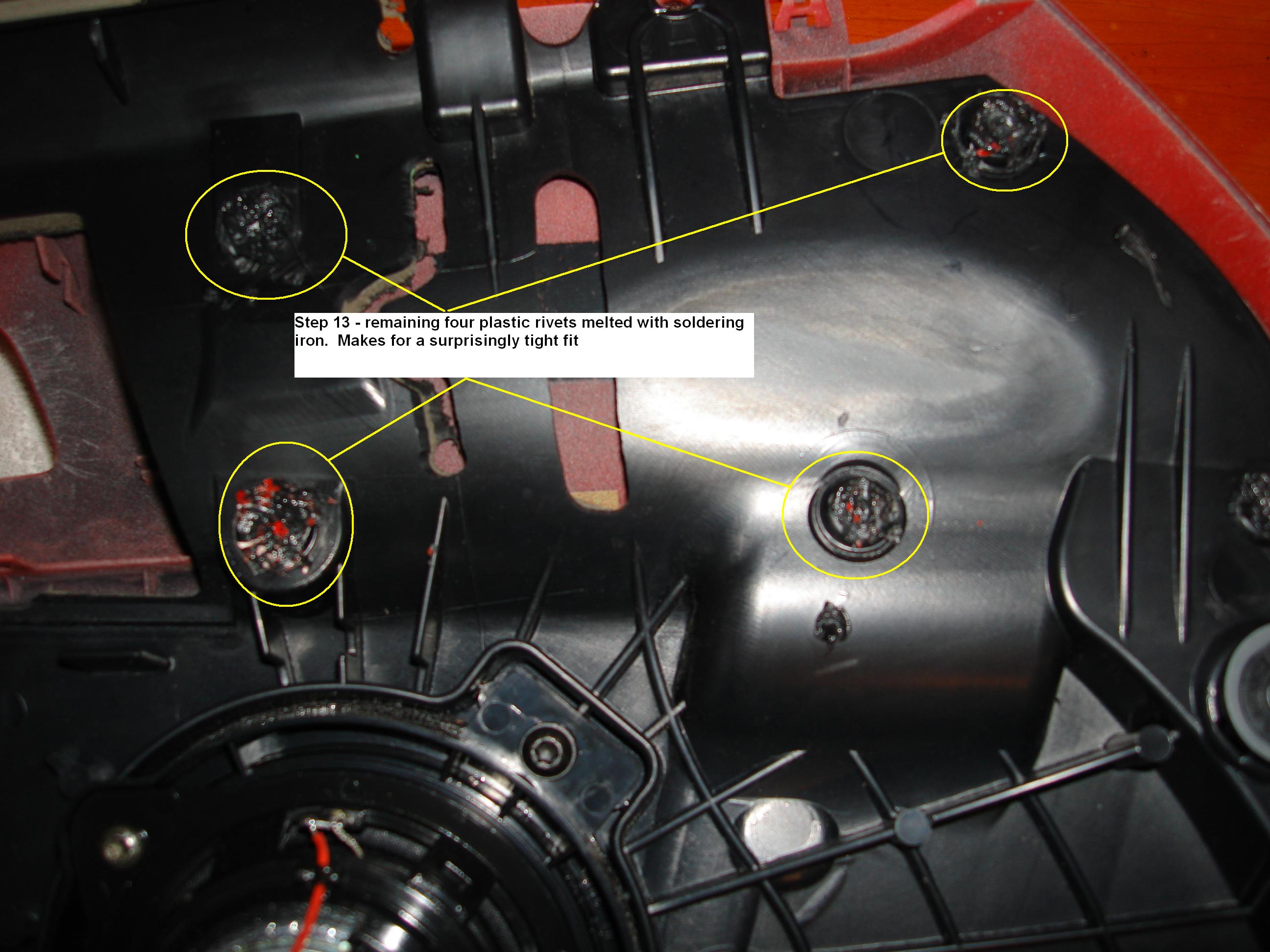

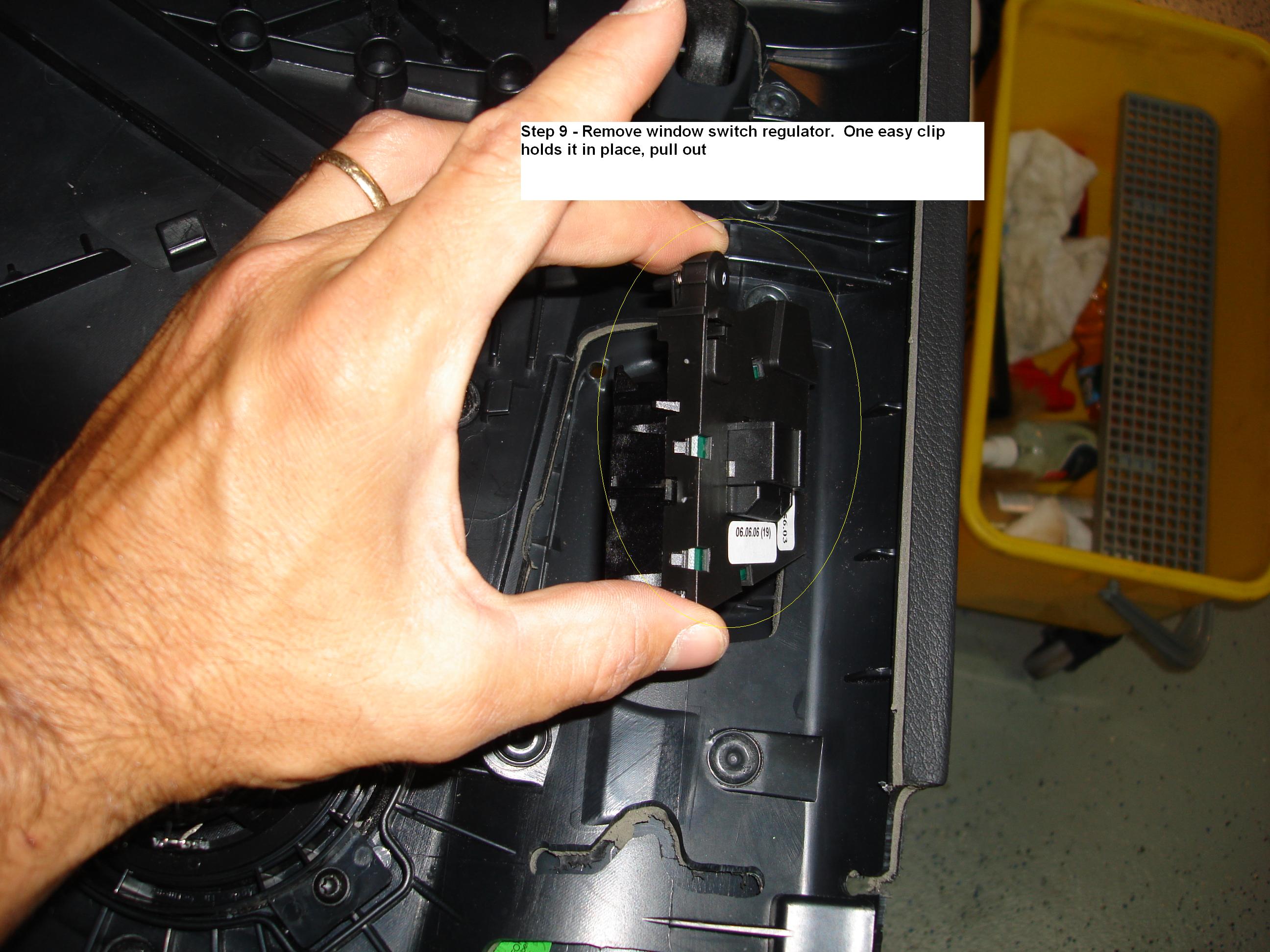

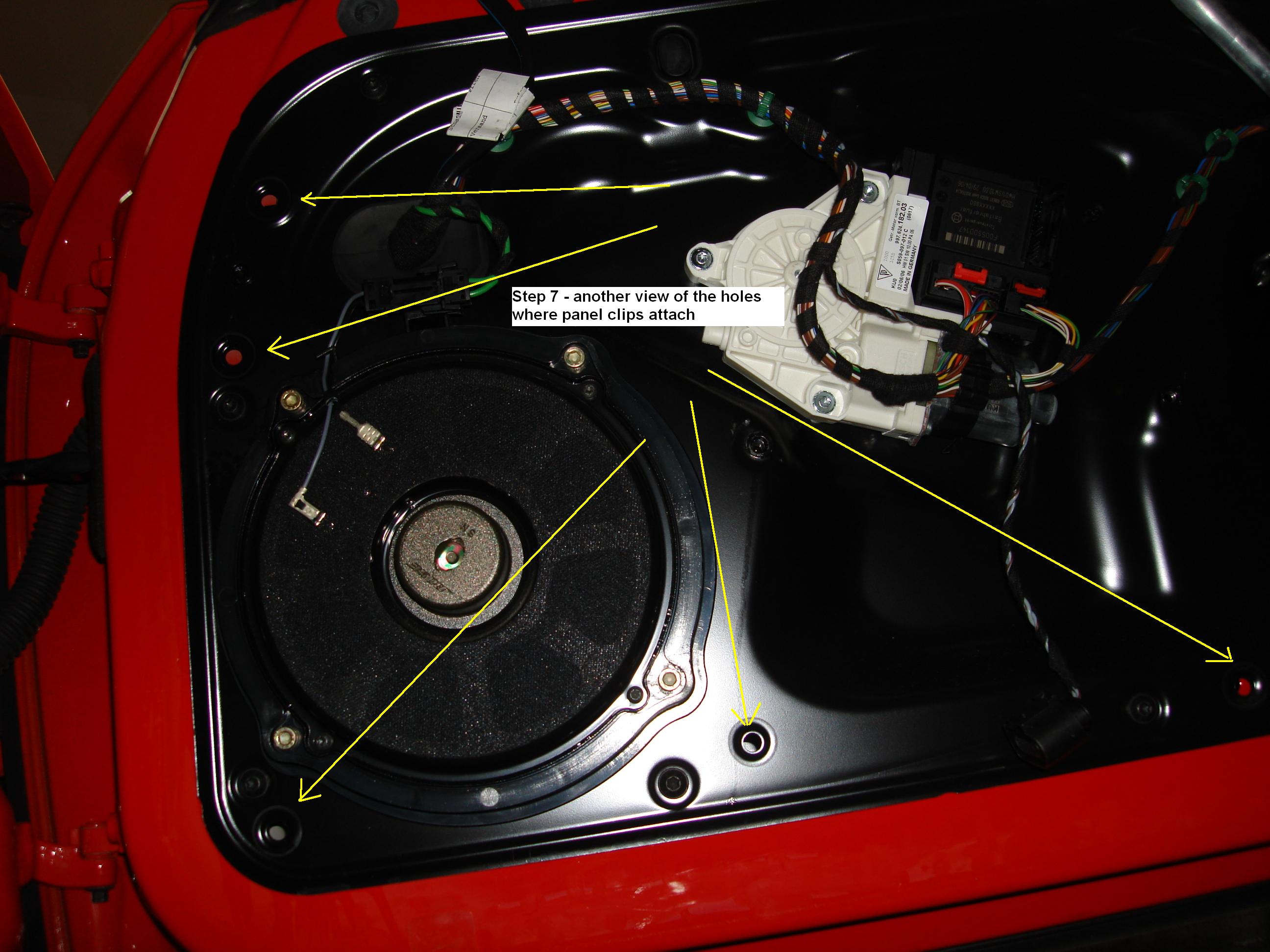

Hi - got some great painted parts from bumperplugs that I wanted to install, but couldn't find the documentation to remove the door panels for a 997. the 987 instructions are close, but different enough to cause a problem if you pry where you shouldn't. So here we go, I tried to document with enough pictures for you to do by yourself. As always, be careful and take precautions when working on your car and around airbags. Gundo PET Diagram of door panel: step 1 step 2 step 3 st

Hi, how did you get from step 6 to 7, tried pulling door panel but nothing, dont want to damage anything
regards Tim
