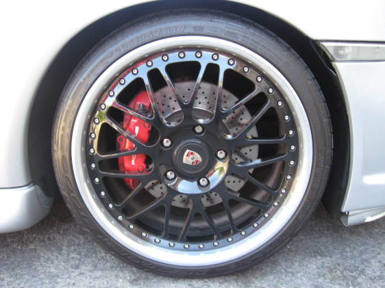

I have 19's on my car with Dunlop SP Sport 9000 tires. I checked the tire pressure the other day and I have around 25 psi on all four corners. This seemed quite low to me. How do I determine what is a correct pressure? The car is lowered with H & R springs and the ride is quite rough.
Any input is appreciated.
Thanks !

Here is what the 997 manual says for tire pressures. Thanks Anderson :D
Tire pressures for cold tires
Summer and snow tires 911 Carrera, 911 Carrera S
18 inch wheels
front 36 psi (2.5 bar)
rear 44 psi (3.0 bar)
19 inch wheels, partially loaded
(up to 2 persons without luggage)
front 33 psi (2.3 bar)
rear 39 psi (2.7 bar)
19 inch wheels, fully loaded
(as of 2 persons with luggage)

A lowered car on 19" wheels is going to ride rough. It's the unavoidable price you pay, and as another poster said, better your teeth than your rims.
I wonder if it's worth looking into adjusting your shocks? There's a good chance that the damping is adjustable, and you might be able to tweak things a little bit for your driving conditions. Just a thought. Me, I'd put the tire pressures where they belong for the sake of handling and braking and try to manage the ride with the shocks.

I was looking at the suspension and it appears that just the springs were changed (previous owner) and the shocks look stock. That is probably why the ride is so bad.
I'm thinking about changing out the shocks but I will have to do some research on what the best choice would be (based on the springs I have.)
I'll put the proper pressure in the tires and see how it feels
