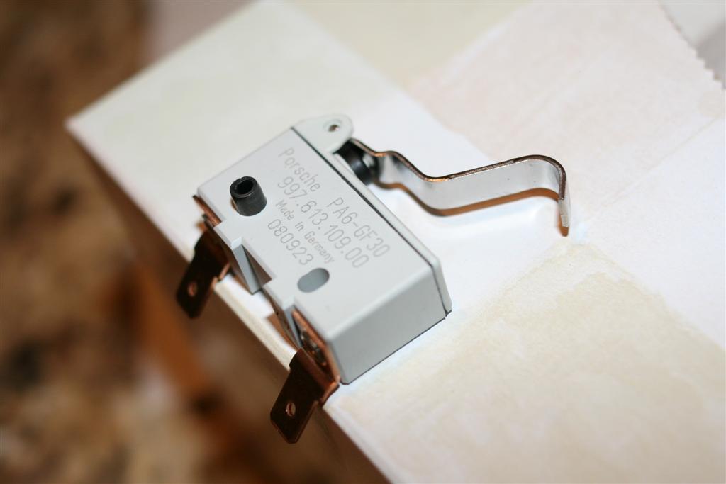

Yes you can. While you're there, you can check if the switch has come loose too. It is held down by a tiny screw through an elongated hole (for small adjustment of the actual point of trigger when the clutch is pressed)
Look for this sucker along your clutch pedal.
