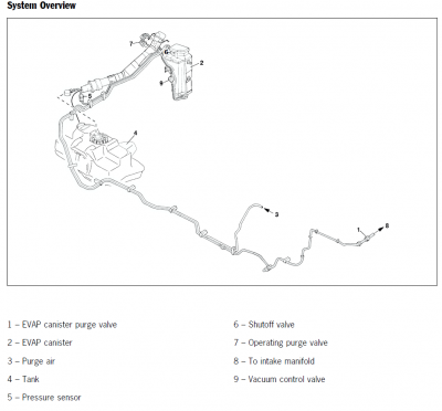

Thanks Loren. Which is the purge air line that I need to check for blockage? Is it the top port of the canister? Would you have a link to a diagram? Would this actually cause the engine to shutoff? Thanks.

More from 7.8 diagnostics
Possible fault cause
♦ Purge air line blocked
♦ EVAP canister purge valve sticks in the opened position (this
causes continuous vacuum to go from the intake manifold to the
tank system)
♦ EVAP canister shutoff valve is blocked/sticks in the opened position
♦ Flow resistance of EVAP canister too high (filter deformed/
blocked)
♦ Pressure sensor connected incorrectly (polarity reversal)
