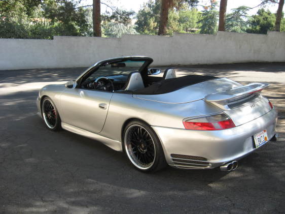

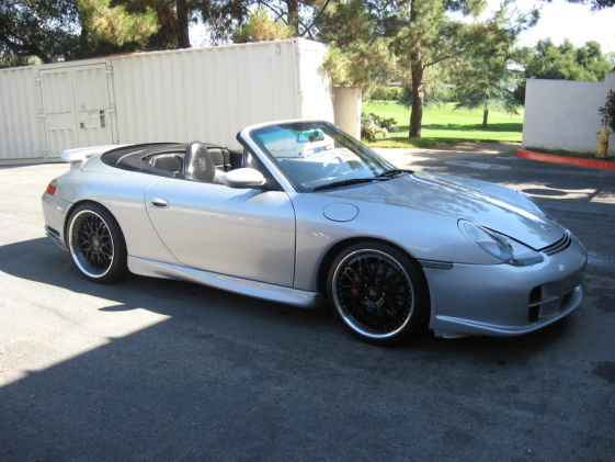

Hopefull, the new rims/tires were set up with very close to the same rolling radius as the 18", so diameter should not an issue. It might just be the photo, but do you know if the offsets were OK--just seems like they are out a little, but again, that might just be the photo.
FYI, I went with PSS10s, and lowered it about 1.5" front and 1" rear, or to 25.5" measured at the top of each wheel well. No problems.
I'm looking at the picture and I think Jon may have a point about the offsets. The front looks a bit off. Attached is a pic of my lowered 996 C2 cab with 19's.
The wheels on my car seem to have a smaller off set and tuck into the wheel well nicer.
Like Jon said though it just might be the picture.
