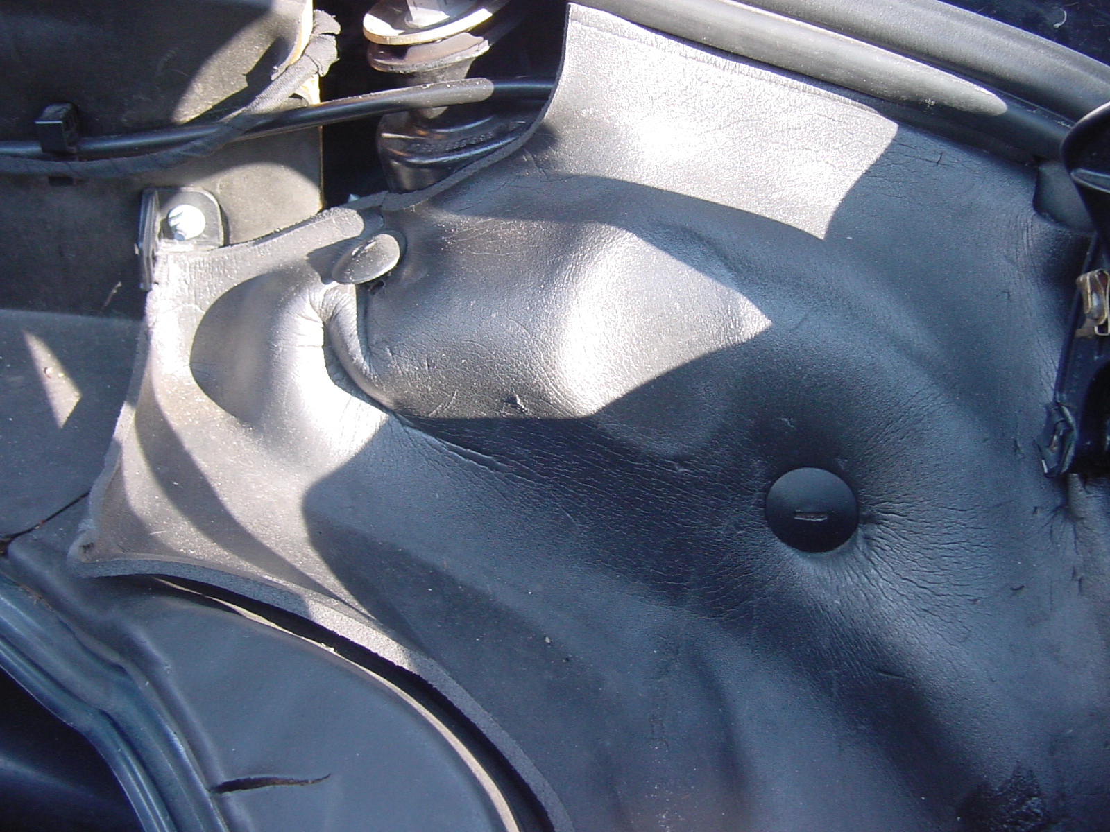

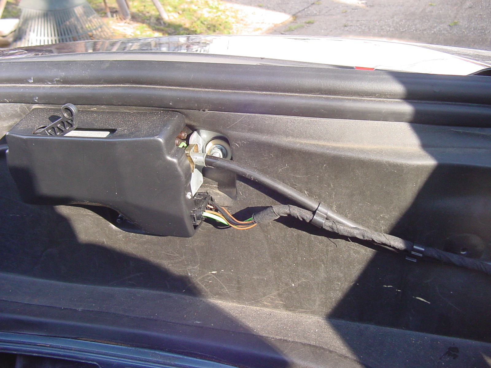

zman:
Here are a couple of photos of the area:
