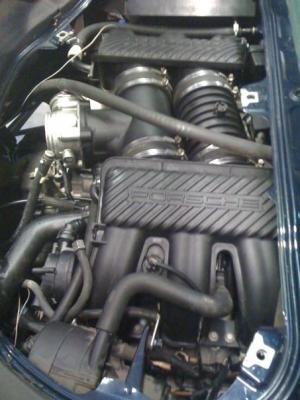

Short update. I did put a 330 Ohms resistor on the MAF and the car works as a charm. It's without question faster than the 4S. The tiptronic works very well too. I'm in the process of replacing the cluster. I am driving the car everyday with no major issues.

Did race a 996 c4 and a 997 c4s. No question that I was faster. Il take it to the dyno when I have some time. I'm chewing up the sti's and evos with no problems.
It's a huge differance from what the boxster was before. Amazing power delivery.

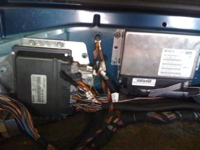

Quick update: 996 cluster instaled; abs 5.3 2001 installed - resolved the speedometer issues.
No more warning lights. The park light is the only one not working at this point.
