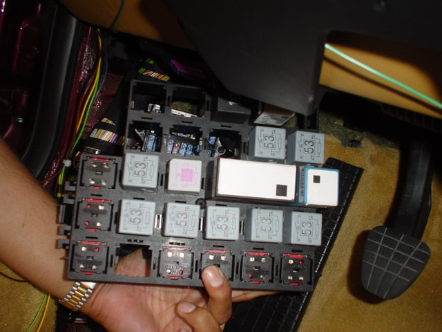

Here is a block diagram (click to expand the image)
Loren,
Is this relay grid located under the front hood somewhere?  I don't recall seeing it in the passenger compartment.
Thank you,
Mark
Down in the footwell where the spoiler switch is.
Pull the cover off - use the hole.
(Jeff's pic - I think)
