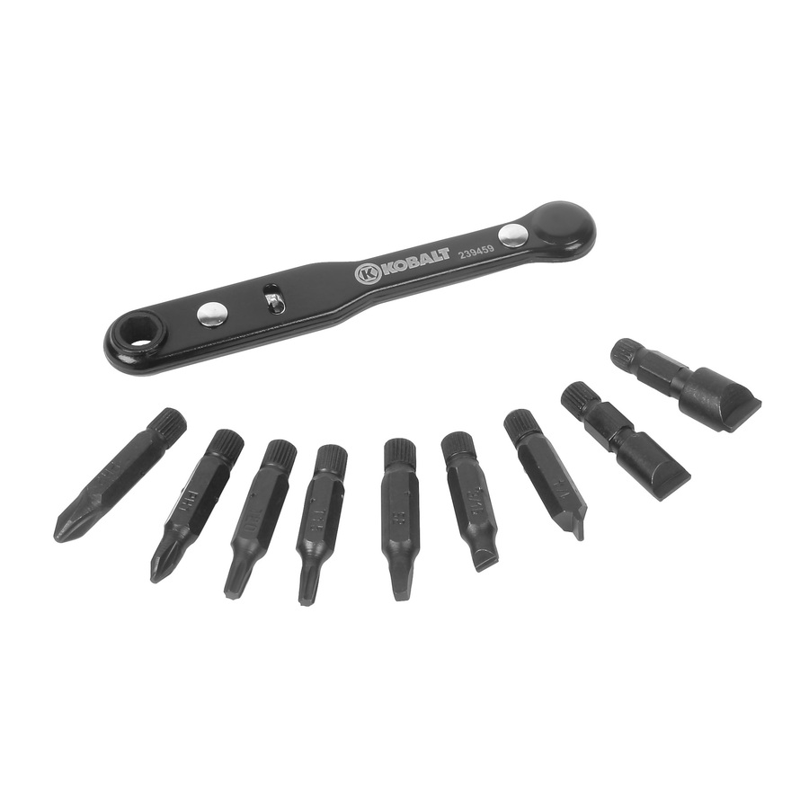

I know it;s an old thread, but I want to try the same fix, but not sure specifically what kind of screwdriver I need, and how to you get that screw out. My hand barely fit in there and there is not enough room for a screwdriver. Even with the velcro straps off.
Thanks in advance
Got it fixed. I bought one of these screwdrivers at Lowes. I did not cut and replace the fabric. I just moved the screw on 3A two holes down and 3B one hole down. We'll see how long it is going to hold. If it breaks, I'll do permanent fix from this tutorial. But now at least I know that I can fix it myself.
