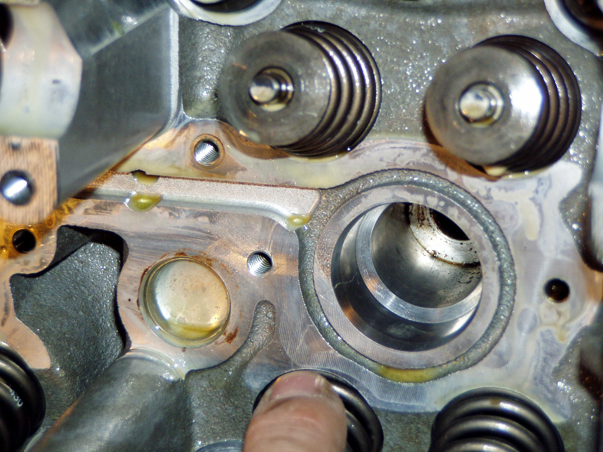

post-7011-1243889797_thumb.jpgI am just finishing reassembling the engine from my 996 after an intermix. It was a cracked head, cylinder #1, inner exhaust valve seat. I did not see it with the plugs and tubes out, not until I had the cam covers off and removed the tappet carrier. Then it was obvious. It seemded I should have been able to see it with the plugs and tubes out once I knew where it was, but I did not see it then.
I never had any smoke in the exhaust or any other symptoms except oil in the coolant and coolant in the oil. The crack did not extend to the combustion chamber and had no effect on compression or a leak down test.
The bottom line is that the dealer taking out the plugs and tubes and running combustion tests and leak downs can be meaningless. Next step, drop the engine, start with head 1-3, as this is the most commonly crarked head. there are also lots of other areas that can carcked and can only be seen with some disaasembly.
Now the good news is that you probably don't need a new engine, although the dealer would probably love to sell you one. I had my head fixed for about $500 and hope to have the car running this week. Keep me posted on what you find.
