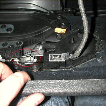

Yes, there is a spring that attaches to the inside door handle. It's probably an easy fix. Here are some great instructions on door panel removal: http://www.ecoutez.net/boxster/door-panel-removal/
I have borrowed one of the pictures and highlighted the spring.
