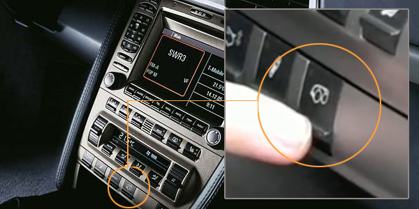

This is what I propose, if its doable and I can get the switch and the panel cut-out for a 5th button:
let me know what you think. Loren, is there a part number for that exhaust switch?

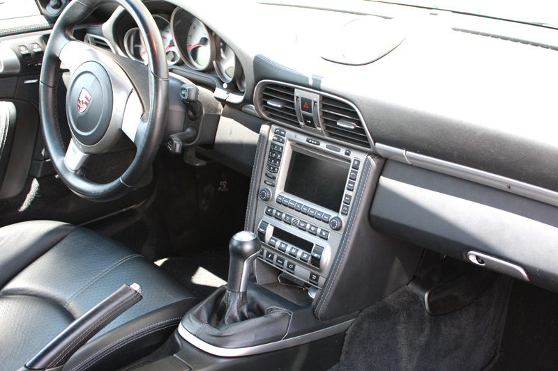

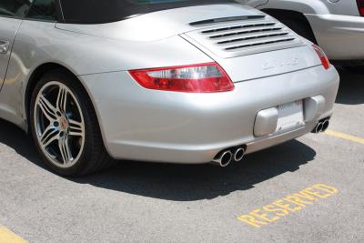

Here's the update,
All done, brand new PSE installed, and wired. Added a fourth button with controls (stand-alone) for the sports exhaust which took the most time since the controls do not exist and need to be wired/added but it came out clean as factory!
Here are some pics I took earlier today, I'm very happy with the sound and the fact that I don't have to be in sport mode to enjoy the roar...
Sam

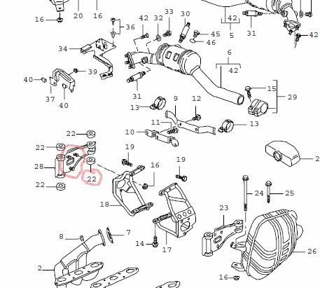

I snapped up a used set of mufflers and tips and bought the vacuum tube/switching pieces from Sunset. I did the install myself. Mufflers took me about an hour each without removing the bumper.
1. Lifted the rear with floorjack, put on jackstand, take off rear wheel (helps with the room needed to slide out muffler towards the front; I've been told it's doable with the wheel on, might be pushing it though)
2. Removed the 2 screws for the brace that comes down to hold the bumper in place (behind the rear wheel)
3. Loosened the clamping sleeve that connects the muffler to the cat (#15/29 in the picture, a squirt of WD40 and some time to work ahead of starting is advisable), slide it back gently towards the cat pipe
4. Undid the 3 nuts holding the muffler brace (red circle in picture, again a squirt of WD40 and give it some time to work first)
5. Gently slid the muffler off the mounting bolts and out of the cat sleeve, lowered it a bit, and extracted it towards the front and bottom of the car.
6. Finally took off the 2 bolts that hold the mounting brace in place on the muffler and swtched the brace over to the PSE muffler
Installation is the reverse. The TSB says you should use new nuts (5 per side) and sleeves.
For the tubing, valve and electrical, followed the TSB - it's on here and if you are a contributor you have access to it.
