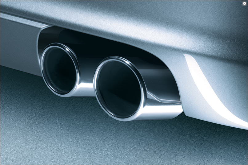

I just bought a 997 MY 2007 C4S Cabrio with Sport Chrono Plus, but I don't know if the sport exhaust were fitted. If I press the sport botton I can hear a change in the sound, which become definitely louder and bold. Are there any other ways to check this feature?

The pipes are different size -- outer pipes are larger than inner ones. Sound is intoxicating isn't it? I find myself hitting the sport button now every time I drive this car. Enjoy your new ride.

montego is right, if your tips look like the pic I have attached you do have the sport exhaust especially if you hear the 'ROAR' after you hit on the sport button.
wow... I guess I have the sport exhaust... the pipes are of different size!!!! :-)

Hey guys i am a bit confused. I thought i have seen factory sport exhaust without the change in the tailpipe diameter? Is this a model specific issue?
