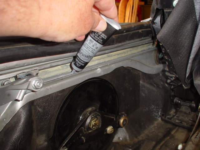

Where does one lubricate the convertible top? Mine squeaks in various places.
What does one use to lubricate? WD-40?
On the rails that the clamshell's arms slide upon, the OEM lubrication is something gummy, like a sticky jelly, what is it?
Thanks to anyone who can help me out. James.
I only do the slides for the clamshell but I guess it will not hurt to grease anything that moves. I use grease in a spray can that has an extension tube so it is easy to apply.
Don't know what porsche uses, perhaps a dry grease that does not attract dirt. On the cars I have seen it was as hard as a rock.

Just lubricated the slides. I had a tube of the grease that comes with a B&M shift install so I used that. I think it is plain lithium grease, which I have also used in the past.
For what it's worth, I've been using a bicycle lubricant. There are several kinds available, but they are all based on the same principle ... a solvent-based wax suspension that dribbles on like water, but leaves a dust-free wax coating on all moving parts once the solvent evaporates. Seems to work really well.
Porsche uses something called Krytox I believe. Not sure on spelling but it's something ridiculously expensive. My dealer used a 3M dry lubricant.
