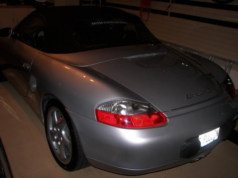

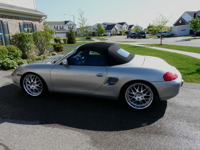

So I found an upholstery shop to replace the top with a nice GAHH top w/ glass window and the headliner will be pinned back into place. I'm waiting on my appointment for the second week of May.

Wow, thanks for the advice! I just picked up my baby from the shop and it looks beautiful. The upholstery shop managed to reuse my previously warped headliner by replacing the rod in the front and using rivets. You really can't tell the headliner didn't come with the GAHH top. I love the rear glass and my worries about the top are gone. Total cost: $1,984. Next up... headlights. Oh yeah.

I went to Mitchell's Auto Upholstery, 22073 N. Pepper Rd. Unit E, Barrington, IL 60010. He did an excellent job! I had the top replaced with the GAHH glass and my headliner needed some fixing since the front was warped and causing it to hang low. Total ended up to $1984 with install, parts & tax. Labor was about $800. I would suggest calling him up and talking with him for a quote.. for the top he quoted about $1975 But may be less expensive due to the headliner on mine which ended up costing an extra 60 bucks to fix. His number is (847) 382-8746. He had a two-day turnaround... dropped off on Tuesday and picked up on Wednesday evening. I would highly recommend it.
